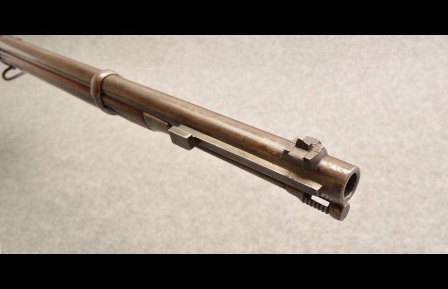

    Here are the photos I have access too:

    That is a nice looking Danishicon R-B. I think the rear barrel-band may be on 'backwards'. The Danish Crown should be on the left-side, when the barrel-bands are installed.

    Nice looking rifle, there appears to be traces of case coloring on the reciever.

    Not big cartouches, just two small crowns and then a slightly larger "something" on the top of the butt stock. I believe the fellow said it looked like a double C or GC of some sort. It's the one I can't see in the photos. I have seen photos of other rifles with this mark, looks like GC to me in a small rectangle.

    It looks more like grease or age patina in zoomed photos. I can't get zoomed photos off their site, had a hard time getting these.

    That looks like a very nice Roller! The backsight is correctly mounted, even if it looks a bit odd. See Layman, Remington Rolling Block Military Rifles of the World, pp71-73. And yes, the middle band does seem to be reversed. Butlersrangers has made the correct comments about ammo. And the receiver is not color-case-hardened. What you see is patina from handling.
    If the bore is OK and there is no nasty slop in the action from worn pins (see my previous post), then you may well have a keeper.

    It is the 'rear' barrel-band that is reversed. The 'middle' band has a 'flanged screw' on the left-side, that serves as a 'Blade' for long range 'Volley Fire'.
    It is a nice Danishicon Rolling-Block. Don't mess with the finish of wood and metal.
