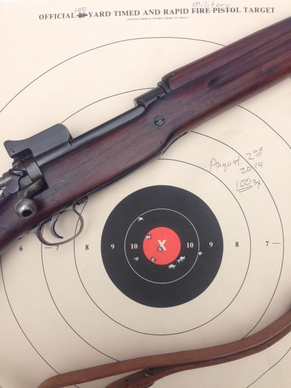

    My Remington with a JA barrel is one of my most accurate military rifles

    Quote Originally Posted by mtoms View Post
    https://www.milsurps.com/images/impo...78f7033a-1.jpg
    I have heard that the JA barrels are very accurate!
