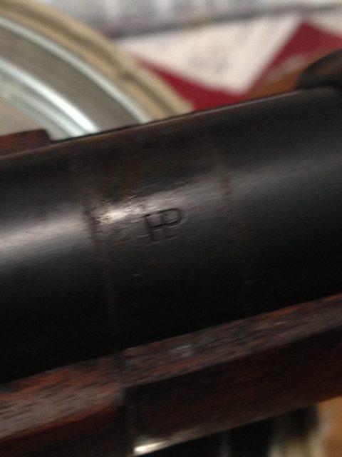

    I inherited a Rolling Block from my grandfather. The thing is completely devoid of details. It has a bayonet lug on the right side of the barrel at the 3 o'clock position. There is no serial number or caliber indication. The bayonet lug and lack of serial numbers have me scratching my head. If it was military why the lack of serial numbers? If civilian, why the bayonet lug? Any help would be appreciated.

    Looks like a Remington rolling block, It could be a Swedishicon roller or from another country that acquired the patent. Are there no other markings? What country are you located in, it might help to narrow it down. To find out the calibre you would have to do a chamber cast with Cerrosafe or something like it.

    I think it is the Model 1879 Argentineicon Remington in 11 mm

    The actions made for smokeless ammo, 7X57mm Mauser 30-40 Kragicon, 7.62 Russianicon, 8mm Lebel etc. are not the same as the Black Powder rifles. The heat treatment is different. As for lack of serial number, Remington made military Rolling Blocks were not numbered.

    Quote Originally Posted by mr.tickle View Post
    Are you sure? Have you tried removing the butt and looking at the side of the tangs - that is a common place for a factory numbering.
    I think the HP monogram is an inspector's mark.

    It looks like one of the Modelo Argentino 1879 rifles that hit the US market in the 1960's. My dad and my brother each bought one out of a barrel at an Oklahoma gunshop, $11.95 each. They were arsenal refurbished during the Peron regime and the barrels were broached to about .446. They are quite accurate, especially with black powder. The brass will last forever if you don't overload it with smokeless, or let it sit with BP residue after shooting.
