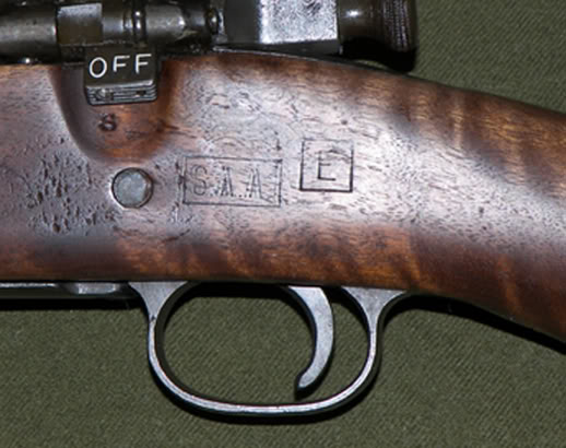

    The 20 is an extranius mark, could be a sub inspector but we don't really know the low down on it. Winchester stocks always show these (as far as I have seen so far) and some Remington stocks show some as well.
    The 20 at the toe of the stock, dont know, the F behind the receiver on the wrist, another dont know. The S in a square is an inspectors stamp, I have an E just like it on my SAA rebuilt 03
    As to the finish, you do see alot of the rifles that still retain thier blued finish or at least significant portions with only replacement parts being parked.
    Dan

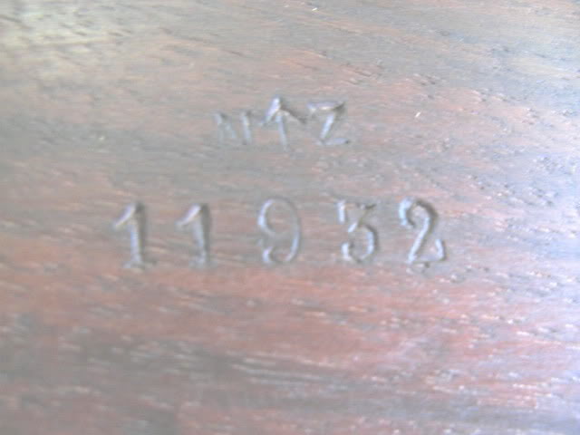

    Or maybe this...
    perhaps it made a trip to New Zealandicon (with apologies for the poor pic)...
