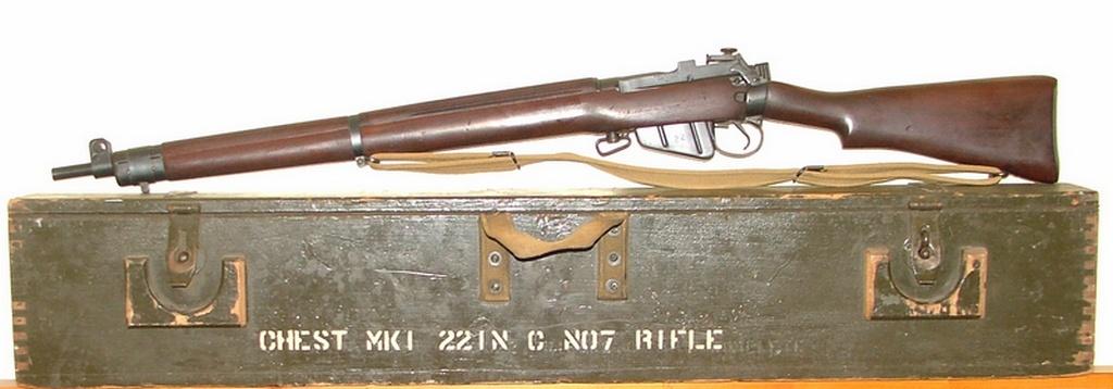

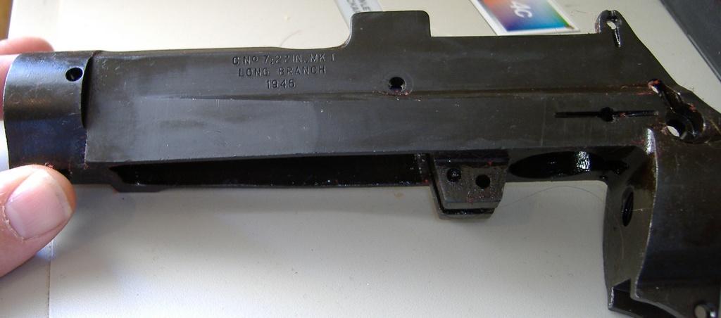

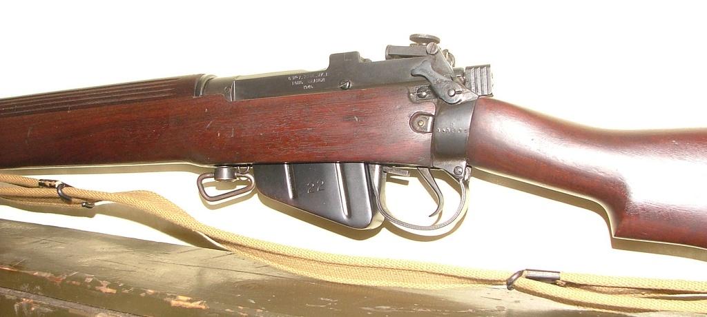

    Several years back I wanted a CNo7 in the worst way. Srarted tio collect parts when I found the scrubbed reciever. Nicely refinished with scrubbed SN. Shortly after I was able to buy a legit CNo7 from a friend that I had found for him to buy from a fellow up on Vancouver Island. I think I paid the then outagious sum of 700 USD for it. Still have the project parts lying around, hardest one to find was the complete rear sight. I had a Savage No4 barrel lined to .22 for the project.
    Here is a pic of the reciever:
    Here are a couple of the rifle I ended up with:
