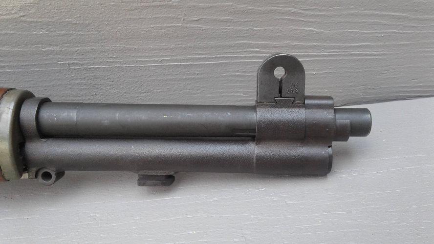

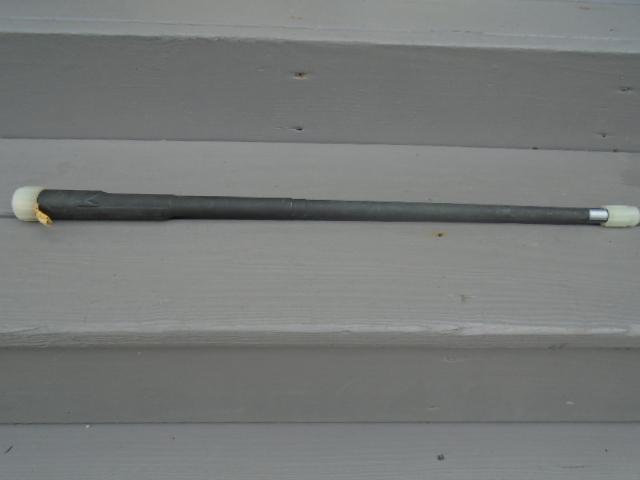

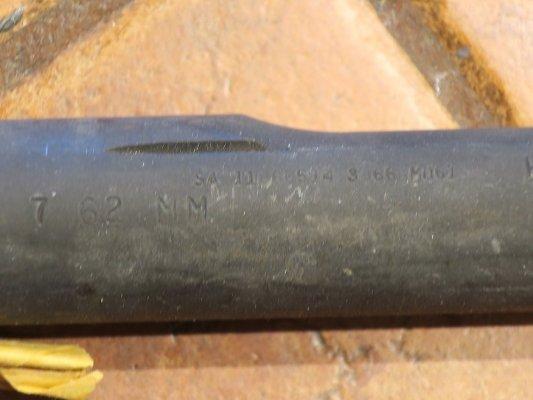

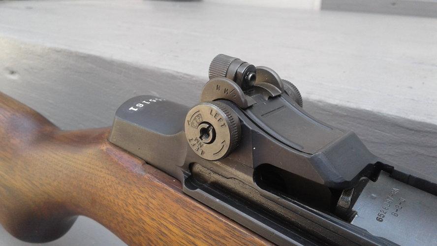

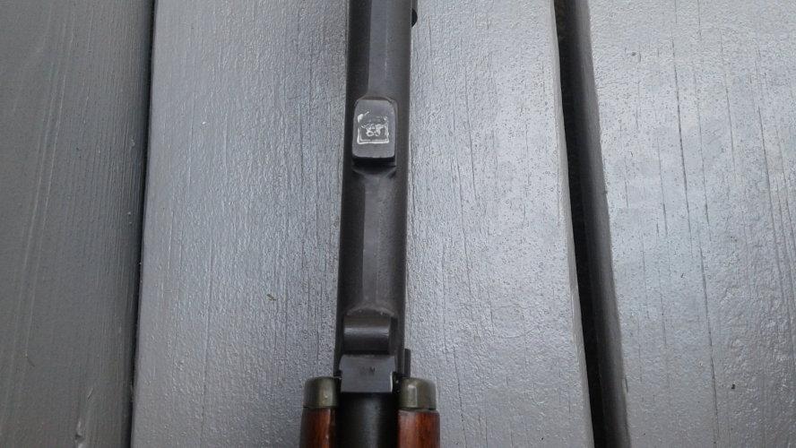

    About 7-8 months ago I picked up a unissued 7.62 Navy barrel on another forum, this was the heart of my latest build .

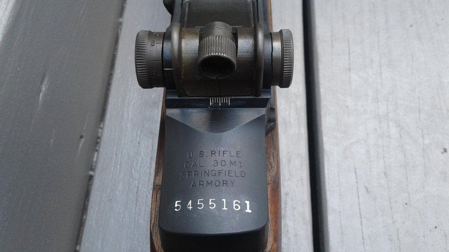

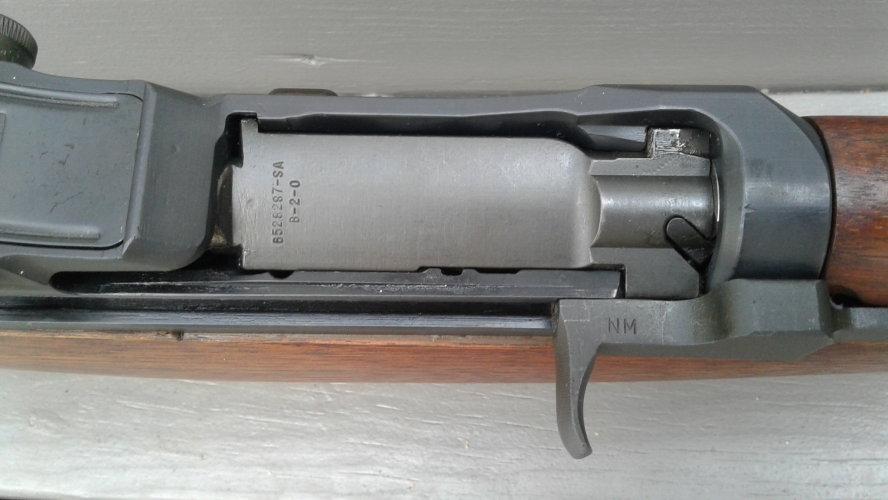

    I installed the NOS barrel on a real nice SA 5.4 receiver ,that I had. Used a NOS 65 Series SA bolt , just needed some lapping to get it to headspace.
    I chose a refinished trigger group I had, and did alittle trigger work to it to where it has a nice 5lb pull.
    Installed excellent condition USGI NM front and rear sights , balance of the rest of parts are unissued.
    NOS Op Rod, NM gas cylinder, 65 series SA bolt, gas screw , lock and internals.

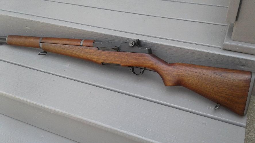

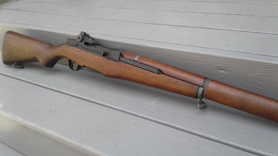

    Did some NM mod work to the rear handguard but that's where I decided to leave the rest to the experts. Sent the rifle off to Ted Brown for a bedding job and NM work to front handguard. He remove the liner, glue and screwed lower band to front handguard
    I am happy with his work and pleased on how this build turned out
    Unfortunately I haven't been able to spend any time at the range with her yet

    Quote Originally Posted by Orlando View Post
    I have to ask and expect the phonebook on this one, why did you lap the bolt lugs for headspace? Why change the bolt instead of ream the chamber? I was taught way back to give the chamber a touch...that was how I got mine to headspace too. It was tight and never had a failure to close, chamber or fire... ??
    Legacy Member Orlando's Avatar
    08-27-2024 @ 05:04 PM
    Ohio
    325
    07-03-2025
    12:32 PM
    Lapping the bolt to smooth contact surfaces for better function and consistent even bolt closure. Bolt was so close to headspacing I was able to lap it and kill two birds with one stone
  9. Thank You to Orlando For This Useful Post:
    Today @ 08:23 AM
    31,164
    07-03-2025
    09:32 AM
    Bolt was so close
    Understood. A ream might take too much in that case.
