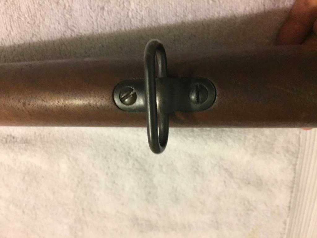

    Thanks... I have some photos.. they will be in (3ea) entries...
    ---------- Post added at 10:08 AM ---------- Previous post was at 10:07 AM ----------
    Here are some photos... I apologize for some not oriented correctly. Photobucket can be a real PITA sometimes....

    And a few more.... As you can see. the handguard is a replacement. I show the original one there also...
