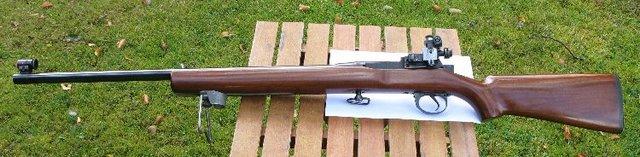

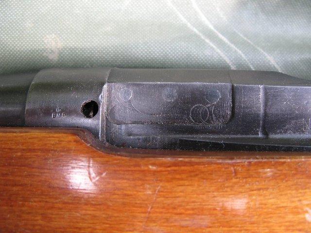

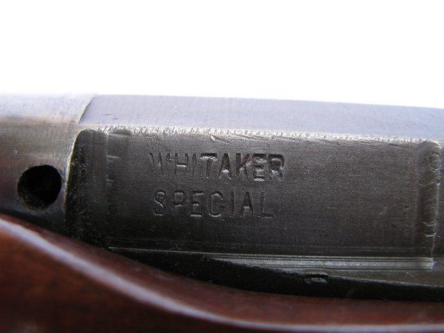

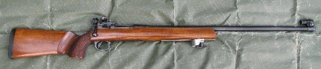

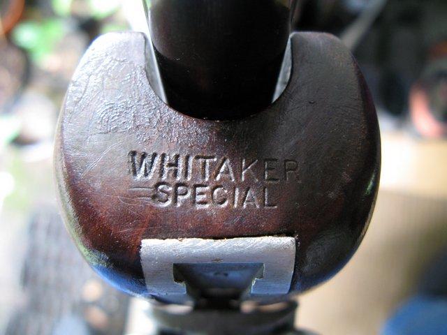

    Herbert Whittaker, known as Bert converted some No.4T's into the "Whittaker Special".
    This was essentially a No.4 with the butt socket cut off and a 7.62mm barrel installed into a piece stock. He converted 117 of them of which I own two.
    An educated guess would suggest around 50 might survive.
    Mick

    I must get all my research down on paper regarding Bert's rifles for an HBSA article before apathy gets in the way!
    The picture of the two gentlemen whom some of you will recognise the man on the right was of course taken in Fulton's at Bisley. The man on the left was a furniture manufacturer who made the stocks for the Whitaker Special.
    Mick

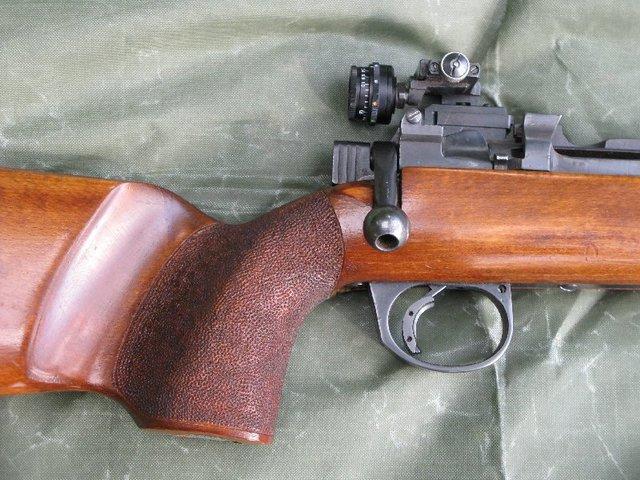

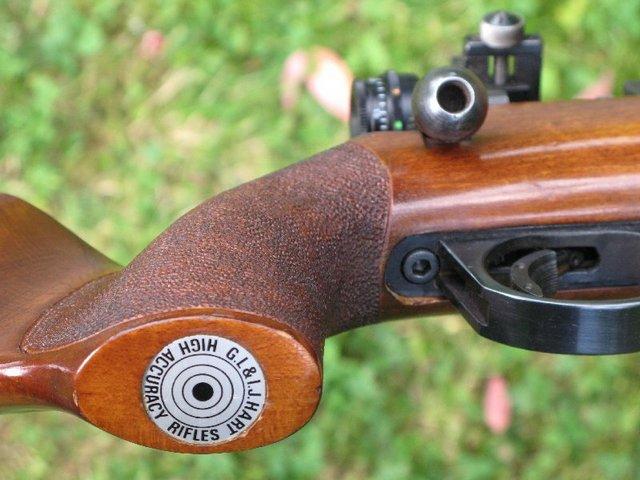

    Quote Originally Posted by bigduke6 View Post
    I've a body only from a Whitaker Special if someone wants it ?? also have a very nice Geoff Hart No4T conversion (Mick you have the info on these).
    Indeed; Geoff Hart bought all of Bert's unconverted stock from Christopher, Bert's son after Bert's death at Camp Perry whilst shooting the Palma.
    Geoff took Bert's design one step further by putting on a slightly longer barrel, different furniture and a Brindles trigger from his friend John Light who also happened to be Robin Fulton's cousin.
    The example I own has a high comb which really only lets me shoot it at 600 yards plus otherwise I cannot see through the sights. It also gave me my first 50 on Stickledown at 900 yards, although to be fair there was little wind that day!
