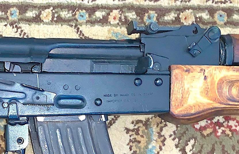

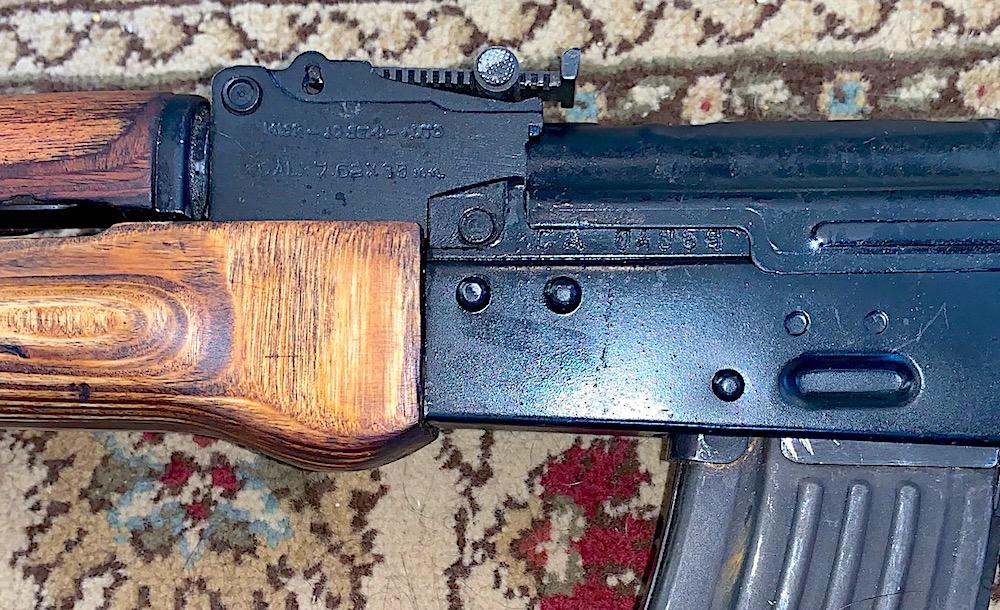

    Finally got some pictures of my Egyptian Girl.... All matching numbers, by the way.

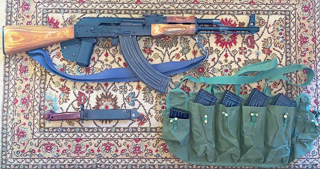

    It was filthy and broken down in pieces in a box when I got it. It cleaned up really nicely, though. The top handguard spring (goes around gas tube) was shot, so I replaced that with a NOS one I had kicking around from when I did Saige restorations back in the day. The gas tube was also a corroded mess, so I replaced it with a NOS gas tube (Hungarianicon, I think) I also had in my AK parts box. It had no cleaning rod, so I got one off ebay, and I got Hungarian muzzle nut from Apex. The muzzle on the MAADI was turned down to around 1/2", so the nut slipped on very nice. I used JB Weld to attach it. It came with the original gas block with the bayonet lug neutered, but the prior owner replaced it with a gas block with bayonet lug. It was pinned perfect, so whoever did it knew what they were doing.
    The bayonet was as pictured, so I ordered a rubber insulator and hanger for the sheath to finish it off. The mags I have had since I had a CA RAW in the 80s. The chest pouch is a Chinese Type 81 four cell pouch that I upgraded with Fastex buckles. I also have a Hungarian 5 cell shoulder bag and a Russianicon three cell pouch and some other magazines kicking around. The Kydex paddle is to make it California "Featureless" so it is not an Assault Weapon.....
