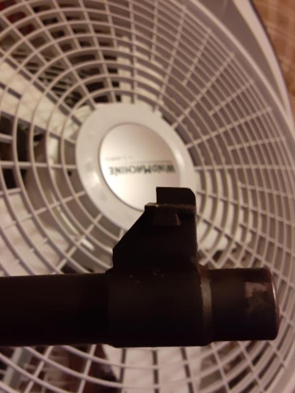

Thanks for the reply. I'm trying to confirm what is in the pic is --03 and not .03. If it is --03 then I should be good purchasing a --015 front blade. I know what to choose I just need confirmation with the starting size according to what I have in the pic.
I'm pretty sure that if there is no - or + then it is a +.
Only the - (less than zero) were marked so a :
03 is + above zero
-03 is - below zero
But if you are looking at anything apart from military blades, all bets are off.

So looking at my pic which do you think it is? Looks like -03 to me.
It looks like there's a - in front of the .03 to me too.
I'm not sure it is. There is a 'scratch' but the (few) I have handled have always had a much more definite (deep) stamping and the 'scratch' seems to run into the 0 whilst the ones I have seen there is a normal spacing between the - and the 0
For the sake of about $1 a piece why not get one of each a - 015 and a +045 then you are covered and only paying one freight charge if you have bought the wrong size.
Yup, that is what I've decided to do just to be safe.
Thanks everyone!
