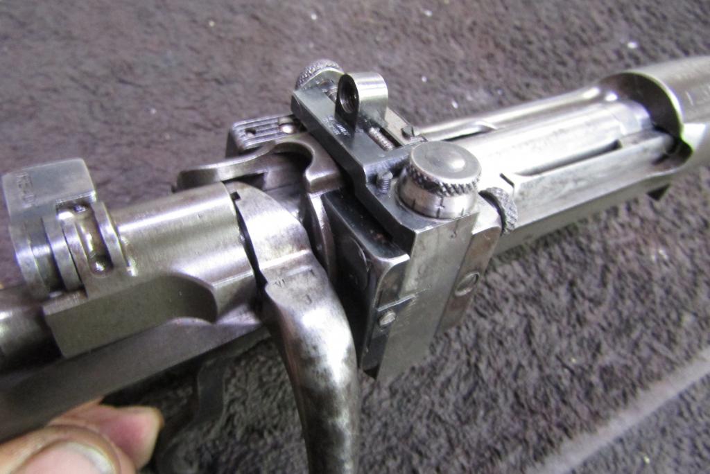

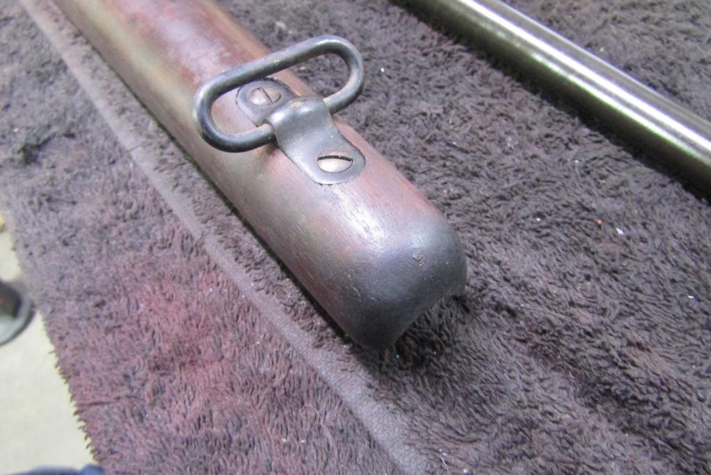

    I bought this for $500 because I can't control myself. When I bought it there was a leather wrap around the barrel where the sight collar would have been. It went all the way to the forearm tip and the barrel channel has been dug out to let it fit. I tore the leather off and I see white metal where the collar should have been. In the SRS list it is surrounded by NM rifles, there aren't anything but NM's in that serial range. It almost looks like one of the 1921 "Free" rifles. The barrel is star gauged, it gauges 1, and it has the Lyman 48S rear sight but I don't know how it came to be. The stock has had a plastic pistol grip cap added and it doesn't look like any of the NM, heavy barreled target or style t target stocks but it sure looks military, especially the shape of the comb. Is this just somebodies put together copy of a target rifle? I can't figure it out. I took some lacquer thinner to the butt end of the stock and melted off some of the spooge and oiled it. It looks like a nice stock except for the barrel channel excavation.

    Here it is all cleaned up. It looks like there was a front band at one time, there is a hole all the way through. I think it cleaned up nice. I just rubbed gun oil on the stock for now. Is this stock from an M22? There is no relief cut for the bolt handle.

    I would say the serial number being in the NM serial number group is strong circumstantial evidence it was built as a
    NM. The stock is certainly a slimmed down 1922 stock. I say slimmed down because the butt is smaller and the commercial butt
    plate is smaller than the original 1922 butt plate. More evidence of it being an 1922 stock is he filled hole near the front of the
    fore end. The hole was for the pin that went through and kept the 1922 barrel band from sliding forward. The 1922 stock lacked
    the reinforcement crossbolts and the morticed out place for the cutoff switch. The Lyman 48S
    rear sight had the windage scale behind the aperture. The windage scale being in front of the aperture is a feature
    of the Lyman 48C. I am not certain but I believe the elevation clicks on the sight are quarter minute. That would indicate
    the sight is later than the rifle. The barrel channel in the 1922 stock would have been too large for the 1903 NM barrel as the
    1922 and 1922M1 barrels were slightly thicker. This would have left a gap around the barrel that was filled by the leather
    wrap. I would say someone wanted a nice sporting rifle so they took a 1903 NM, a 1922 stock, a commercial Lyman 48C
    and Neidner type butt plate and made a very close replica of the 1903 NRA Sporter that went into production about 1923.

    The sight scale goes to 125 yds, I think at least the scale is right for the match rifles. What would have gone where the original sight collar is missing and the barrel is in the white? The bore is like a mirror an the muzzle gauges 1.

    Your rear sight, a Lyman 48, does not go to 125 yards. With a 24" barrel the "125" is the number of MOA that the sight moves and I do not believe that the entire 125 is usable.
