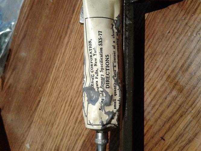

    Early grease tube, as I remember gas trap era. Unfortunately its not in the best condition
