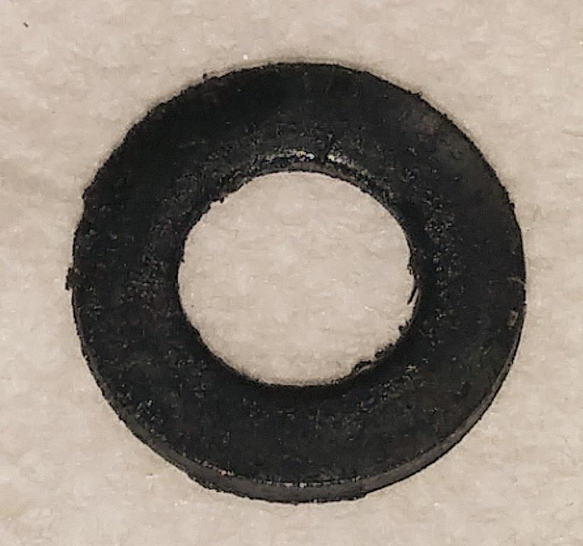

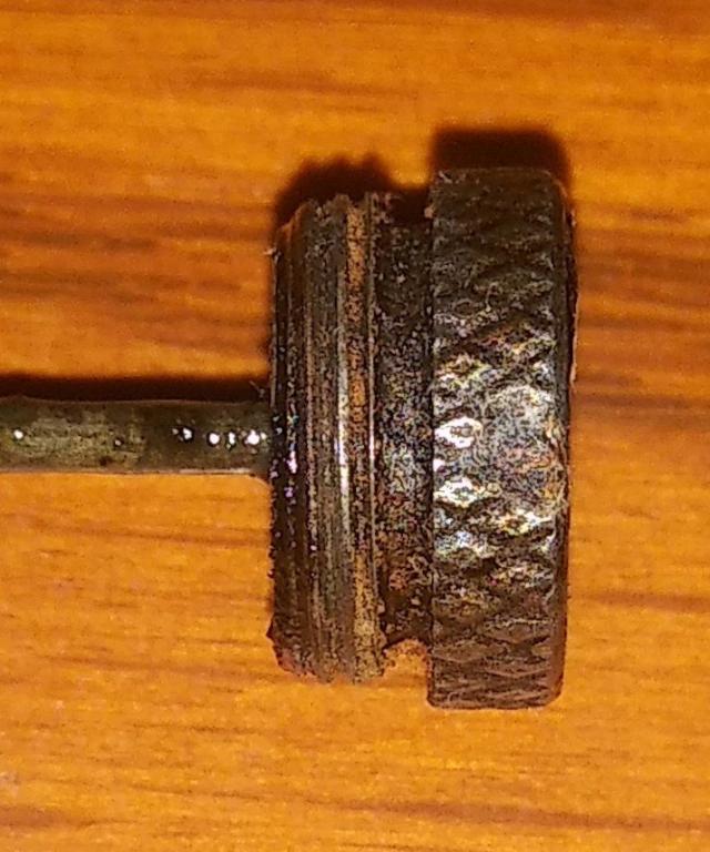

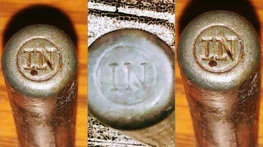

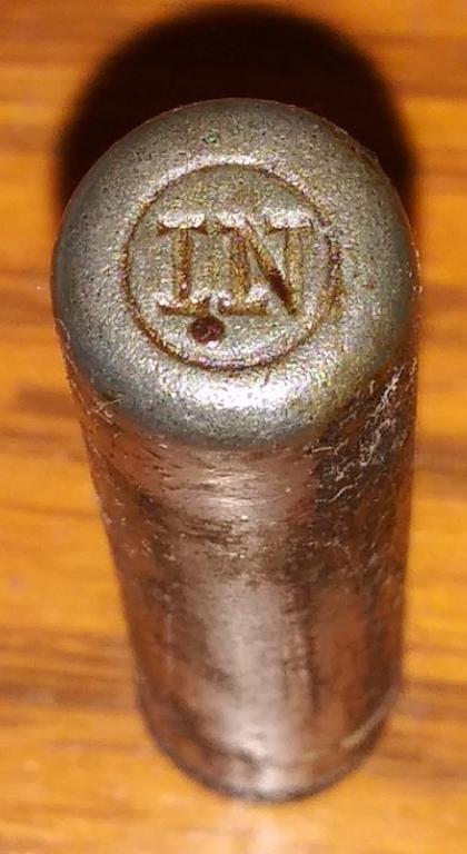

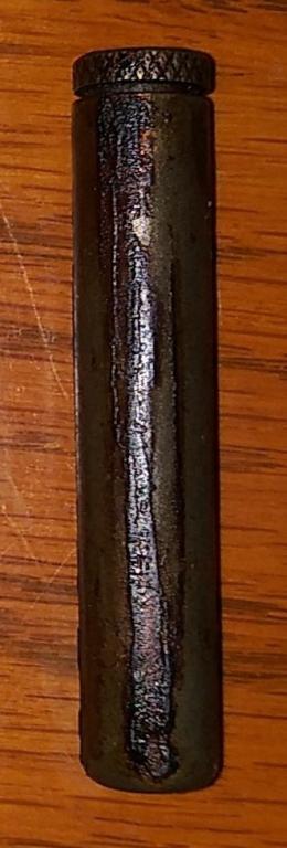

    I know I've seen fake Oilers and I think there easier to spot than some M1icon Carbine parts. I purchased a small groups of parts and it had a "IN" marked Oiler. I really didn't expect what happened after the purchase. I received a email from this guy who was telling me that the Oiler in that group was fake. For what I paid it wasn't bad at all, but he said that he collects NPM's and buys donor parts until he finds Original ones and asked me if I wanted to recover some money that he would gladly purchase the Oiler and a couple of the other parts. Now I'm wondering about it since he seemed Very interested in it. I only have 4 buys on that site and I'm sure he seen that. I was hoping to get some input on this Oiler to see if it is what he said since it does look like it has been messed with or at least I've never purchased one looking like this. Thank You

    If the washer is leather, then it is not a fake. Needs a good cleaning but looks more then original and with so many available I don't think too many are going to fake them.
    Thank You Bruce...I've only seen Oilers with Longer thin letters and this type. I appreciate your input.

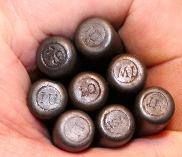

    Picture From George's auction of 8 oilers........ The IS may be real, the others not so much.
    Attachment 114850

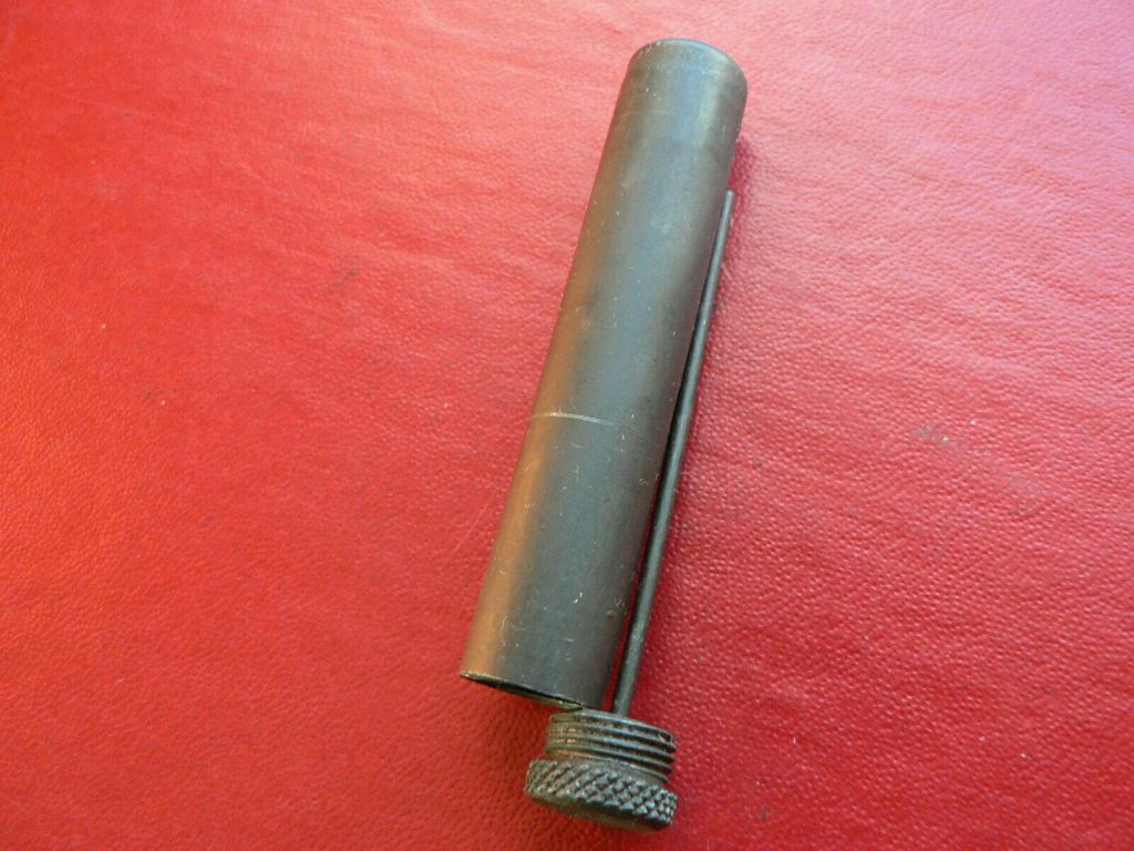

    $70 Buy Now Fake IN Oiler
    Franks Real IN Oiler here to compare the stamp:
    Wayne mentioned this seller above.
    Here's one from Ebay, A Fake/Repro IN stamp. It appears the Knurl on the top looks like the Post WWII Yankee Hill Oilers of which some were made for US contracts IIRC, But the Tube looks thinner, I can't see enough to be sure.
    When you open my attachment you can pull it up next to Franks to compare the stamp. Someday I'll learn how to do the side x side pics:
    Attachment 114852
    Here's the Auctions Knurl pattern on the cap:

    =Patrick Chadwick;492651
    So if it was fake, why was he so keen to buy it?
    Patrick, Your reply is exactly why I posted this. It just seemed to me he probably missed out and then emailed me to see if I would go for it.
    I don't know if I missed it, but you can clearly see the size difference in the Letters...Hmm !!!
