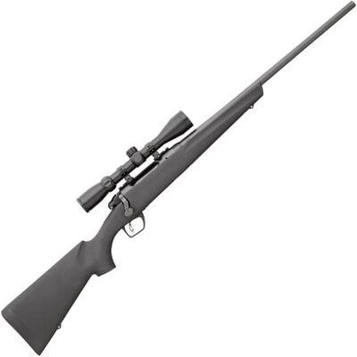

    300 WIN MAG would be fun. I have a Remington 783 Bolt-Action Rifle with Factory Scope in 300 WIN MAG. Bought it 2015 and it still new in the box, I've never shot it. I only bought it because it was on the clearance shelf - It's an ugly rifle that has that small ejection port.. LOL but I could not say no to a 300 WIN MAG at just over $200.00 US
