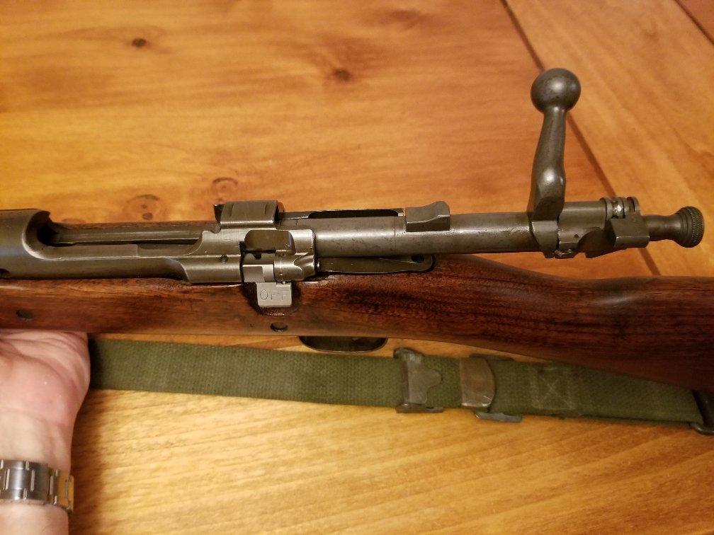

    Looks like a nice Remington 1903 from WW2 era. It's serial range is 330xxxx, with barrel rollmarked 4-42. The replacement stock is stamped faintly with "RA" and Inspection stamp of "FJA" in a square box. It should have been stamped with another inspector initials. The stock was sanded down in a previous life, but still looks very nice today. Here are some photos....

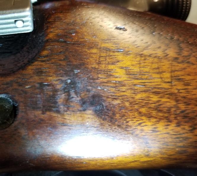

    Very faint stock markings.

    Originally destined to be an 03a3 but due to a shortage of rear sights the rear bridge was milled down to mostly remove the sight base and the rifle was completed as a regular 03. Nice rifle and I’m not sure that’s the wrong stock.

    If it has a 4/42 RA barrel, the barrel was probably replaced at some point. A more correct barrel would have been in the 11/42 or 12/42 range. The stock is a replacement - the markings are for a later M1903A3.

    The barrel is rollmarked as a 10/42,
