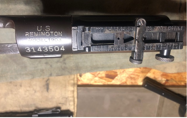

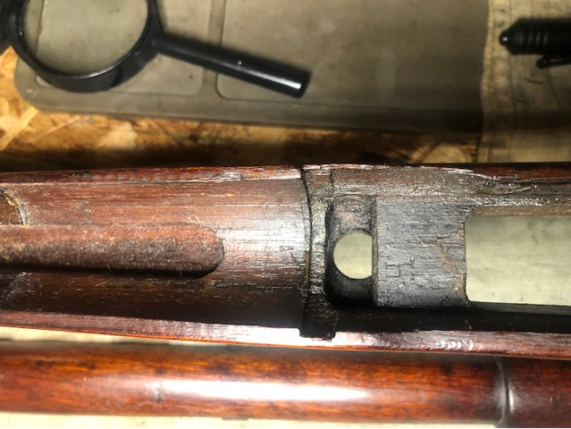

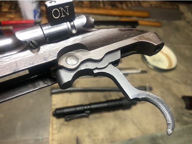

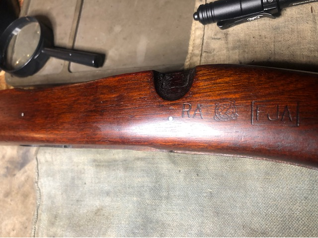

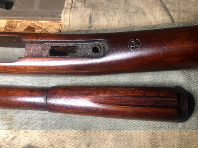

    Hello all,
    So I am cleaning up and data sheeting a pretty nice RA 1903 I have had for some time. Serial # 3143504 DOM 6-42. Receiver serial and barrel date are to the same month. All milled with the exception of the butt plate which is stamped and parked. Bolt body is SC {"2" and punched on the root}. I believe the extractor, collar and cutoff are also SC. Serrated Trigger and Sear are S marked which I believe to be SA. Rear sight is "G" marked {Gotham?}. Everything else is R marked. No rebuild cartouches are present. I have been told this rifle would qualify as a "Modified" 1903. I believe the serial number is in the correct range. I know that some of you reject the term "modified" and using "type" to describe these stocks. That being said, after all of that here is my question: My Rifle has a type 11 1903A3 stock with recoil pins and is cut for a hand guard clip. Cartouches include RA, cross cannons and boxed FJA with a single non serifed circle P on the wrist. High Hump hand guard with sight groove. I have been down the rabbit hole on the stock thing and I know that many say that stock should never ever be on a production 1903 and I see others disagree. I am not an expert but I do know that in 1942 things were moving fast and these A3 stocks did exist. Its obvious my rifle received some non RA parts along the way but my main concern is the stock. Do we think that rifle could have received that stock at the USGI armory level and can I call it modified or {transitional?} See the pics. Thanks for your time-

    Great pics!
    The stock is CORRECT for that SN! A3 S-Stocks stocks were introduced early-ish 1942 and there was mixed use until depletion of the older stocks. Early RA S-Stocks temporarily used reinforcement pins instead of reinforcement bolts as part of the cost reduction efforts that ultimately resulted in the A3 series rifles, until they realized they were not strong enough to prevent splitting due to recoil. Some of those stocks were even refurbished by removing the pins and installing bolts. I used to look down my nose on pin reinforced stocks until I realized they were getting a bit scarce AND were a very visible aspect of the '03 history.
    The 1942 RA M1903 rifles were in fact ALL designated M1903A1 (modified) Springfield rifles (I always refer to them as M1903A1(m).) Only the 1941 RA '03 Springfields were called M1903A1. They had an RA 1941 barrel, old style rear sight body with the lightening cuts, and even finger grooved '03 S-Stocks.
    So, find an RA milled smooth butt plate, double check the correctness of the bolt parts, double check the trigger/sear (I could be wrong, but I dont think they used serrated triggers and most of not all were marked R unless they were NOS from Rock Island that came with the RI manufacturing equipment, NOS inventory and WIP parts and 200000 stock blanks when RA contracted to use them for WWII '03 production), and double check the handguard type for correctness, and you are good to go!

    With the gun entirely rebuilt, any stock is possible to be found with the barreled action.

    A 1903A3 stock would not be correct for the OP's rifle.

    correct stock for the OPs rifle would be a straight grip stock, no grasping grooves, cross bolts marked RLB out of a box. smooth buttplate, R marked underside, all the other parts should be milled R marked as well
