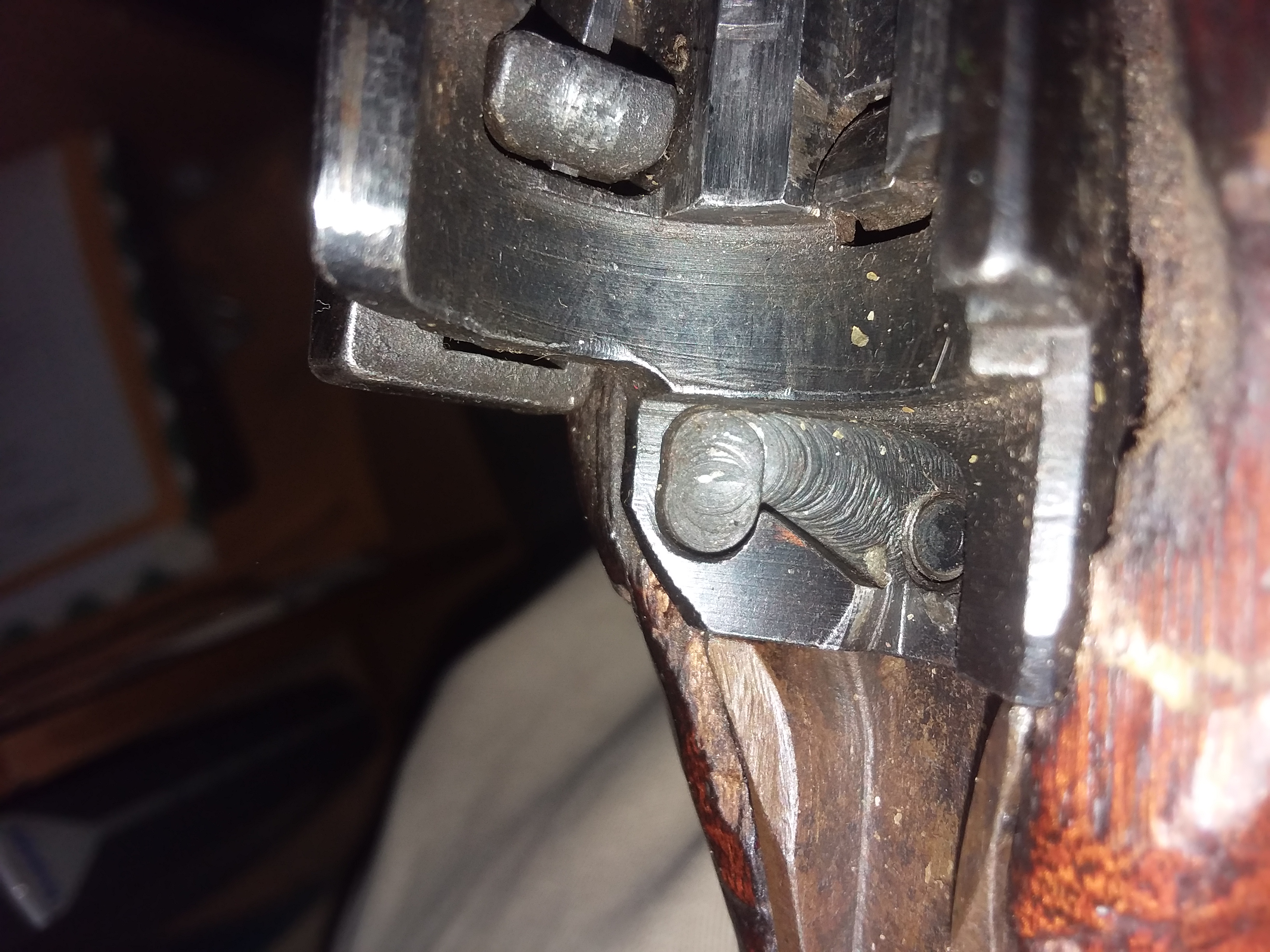

    Question Arisaka TY 99 Last Ditch
    I just acquired this rifle (Nagoya Series 10) 2-weeks ago. It is in fairly nice condition but I cannot figure out the safety lock-out. I can easily push the cap in but it will not rotate to lock. Production was estimated to be around Feb '45. I'm thinking the 'twist-lock' feature should work -- the other possibility is that this feature was deleted from the rifle to trim one more time consuming production step.
    I have pulled the bolt but cannot determine what should be providing the lock feature when the cap is rotated. Some pictures of what should be locking up would be appreciated.
    Thanks -- Randy

    The rear of the receiver has a machined groove which interacts with a small lug on the safety knob. To engage the safety the knob is pushed in and rotated clockwise. The small lug then follows the groove and is held by the groove and rearward spring tension from the firing pin spring. To disengage, the safety is pushed in and rotated counterclockwise.
ID:	122843   Click image for larger version
ID:	122844   Click image for larger version
