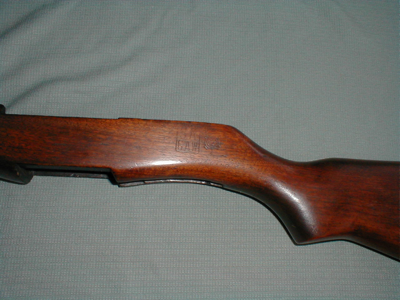

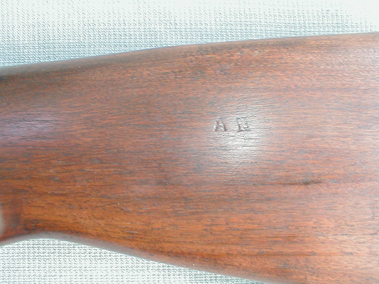

    I ask because I just recently found a 30xxx receiver with an 8-44 barrel, but the most peculiar thing about it was that underneath the SA GAW stamp was an earlier WRA RS stamp. I don't much (or honestly anything) about rebuilds, but I found it interesting that, all other parts aside, a pre-war Winchester stock would have made its way to Springfield Armory at some point in 1944.

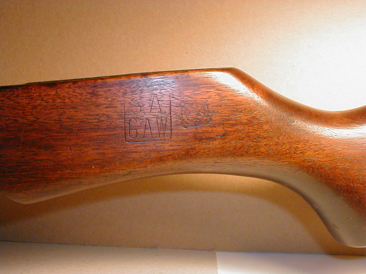

    SA GAW cartouche and rebuild stamp
    By 1944, the SA GAW stamp was being used as both a inspection cartouche on new production rifles and as a rebuild cartouche. I have owned or have seen the model 1903A1 and 1903A3 stocks with the rebuild SA GAW stamp. I have also seen M1icon rifle stocks with the rebuild SA GAW stamp too. Your WRA RS and SA GAW stamped stock is not common to find. Re: serial numbers, I remember the NCO's always wanted the low numbered rifles with five or six digits as the number was easy to remember
    My photos show a Winchester stock with the SA GAW rebuild stamp

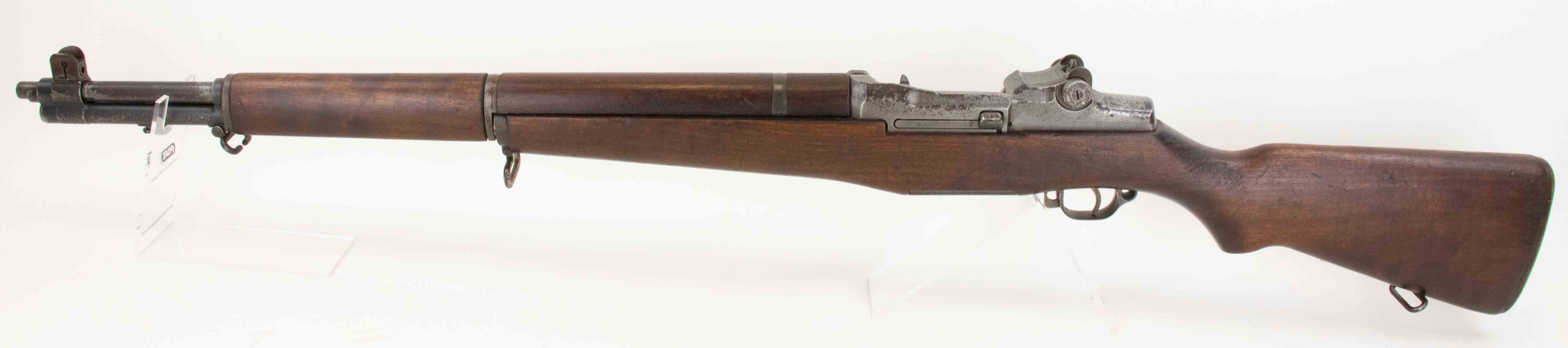

    I do not have the rifle in hand as I purchased it online after noticing the hidden WRA stamp underneath the GAW, but I will provide the photos I have online. I personally can't decipher whether it is a genuine postwar rebuild, a CMPicon put-together, or a self-assembled put-together; I'm sure someone with experience could better decipher that. But it is interesting in that it has an array of Winchester parts on it, particularly the rear sights, with beveled Lockbars but checkered elevation knob. It does have a correct operating rod with a small relief cut in it as well. Imgur: The magic of the Internet
