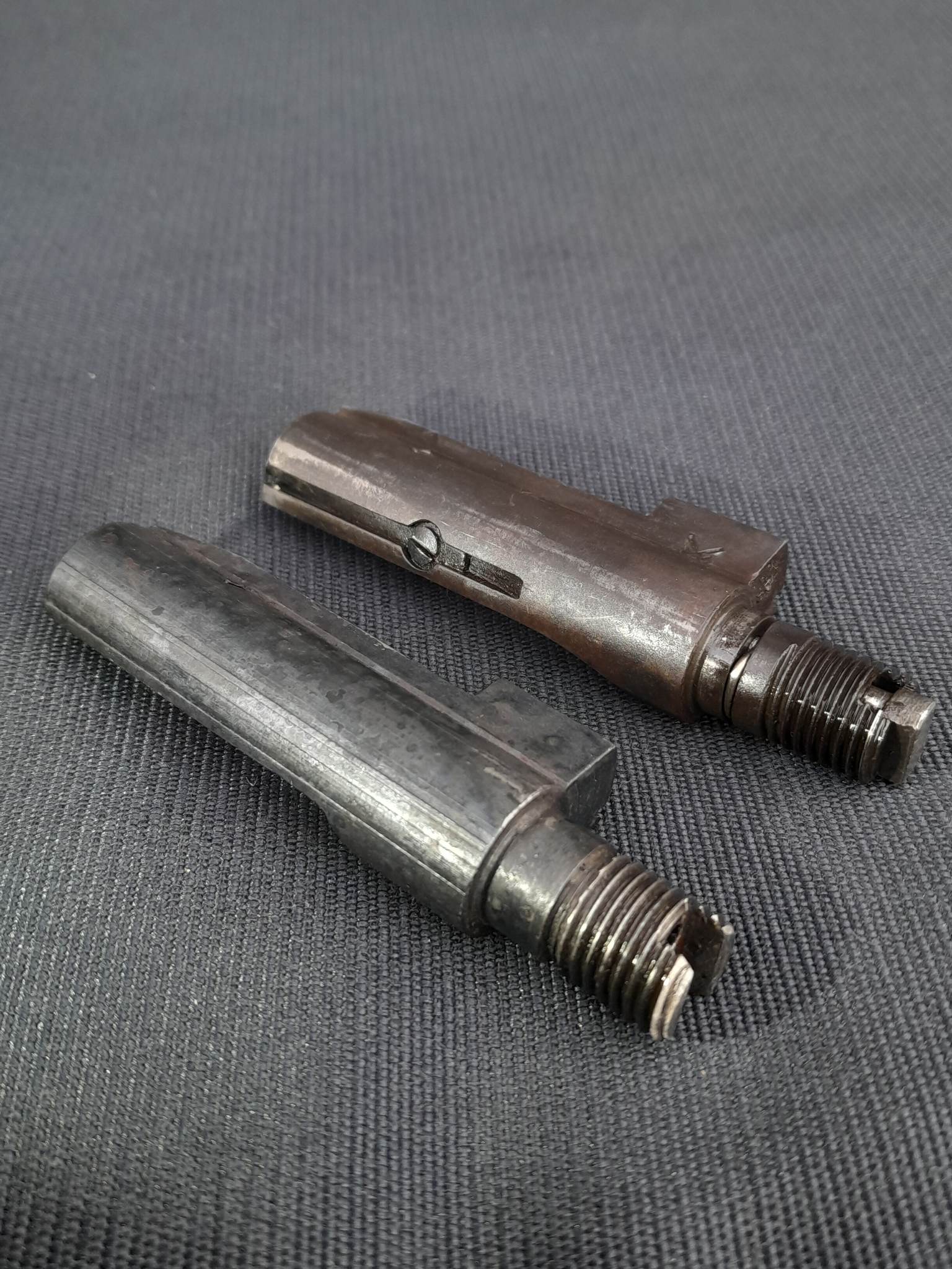

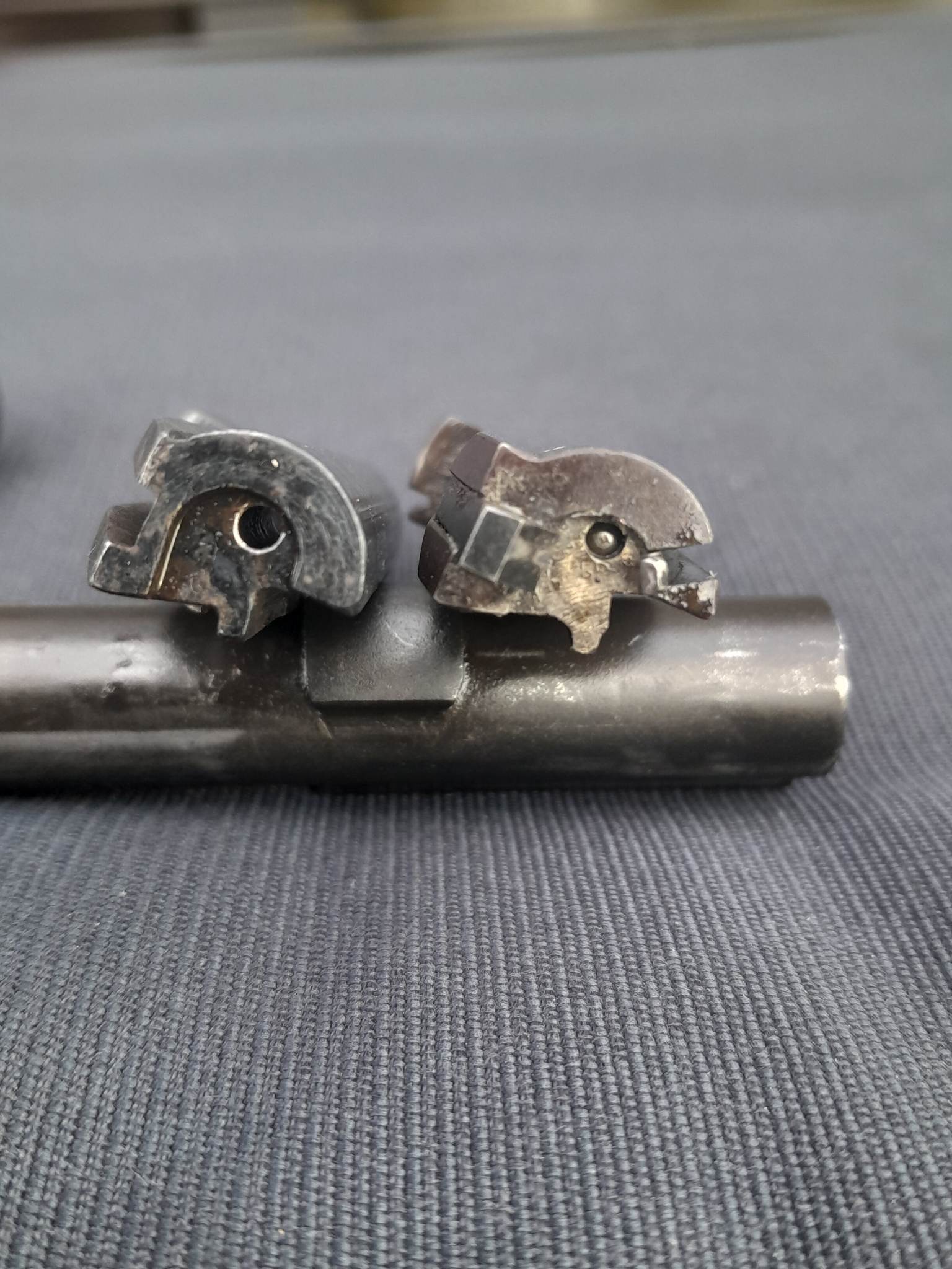

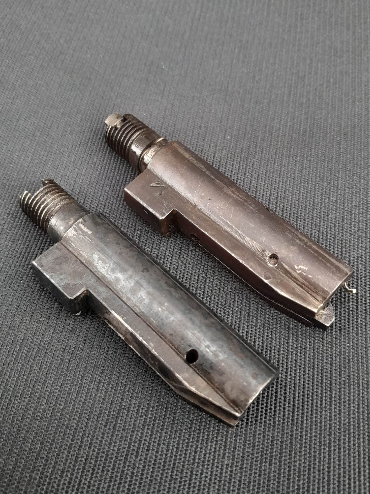

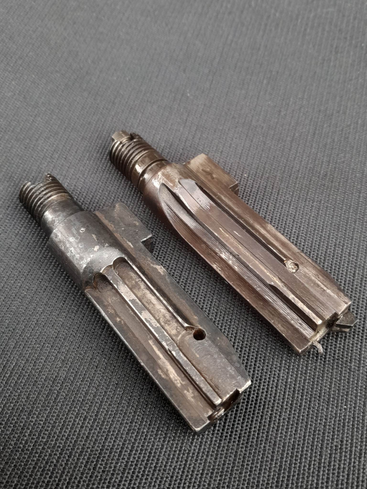

    No7 bolt head ?
    When in doubt or completely in the dark.... rely on the collective knowledge of the group.
    I was asked what the left hand bolthead is from? No7 on the right for comparison.
    I have no knowledge about No7's or later versions of the Enfields 22's.
    If i had to guess, maybe from a CNo7 ?? I think i might have read, there was slight differences between the two rifles?...

    I'm no expert on these either, but I wonder if it could be the bolt head for the No5 .22 prototypes..........I think I might even have a similar one somewhere myself. I believe the CNo7 had a similar bolt head to the N9.
    Keen to know what the experts think....

    A C No.7 used a standard .303 bolt, with a rimfire bolthead. The .303 firing pin became a striker which made contact with the rimfire firing pin in the bolthead. Not unlike the .22" SMLE based rifles.
    Your boltheads are very similar except that one has the positioning finger opposite the extractor, while the other does not. I have no idea if one is a standard Britishicon No.7 part and the other is a variant.

    They are not mine, but my friend who they belong to did mention that he was wondering if it might be for the No5 .22 prototype... so maybe there is something there.

    Thanks Patrick for putting up thoes photos on my behalf!, I can't seem to be able to upload them from my phone.
    That "other" bolthead in the left of thoes pictures above is the same size dimensionally as my BSA no7 bolthead. but there are some machining differences on the underside and not machined for right hand spring groove or the little firing pin circlip at the rear by the bolt body threads. So it's either from something else or was there two different boltheads available for the no7?
