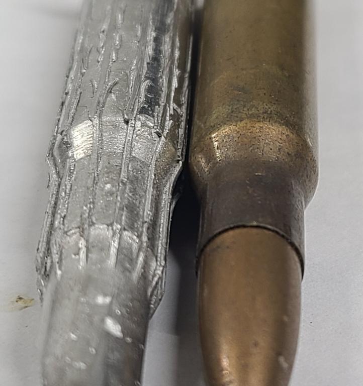

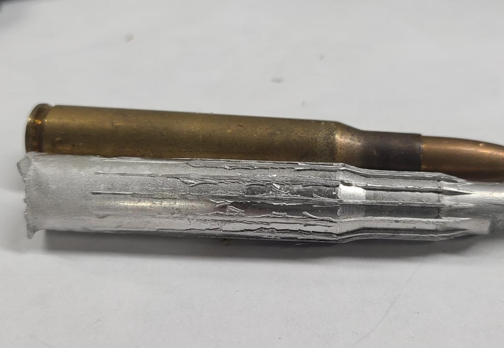

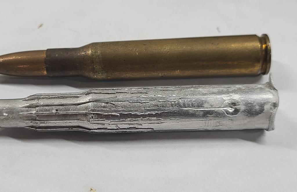

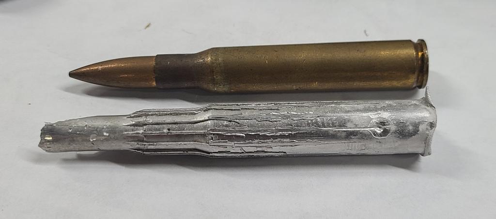

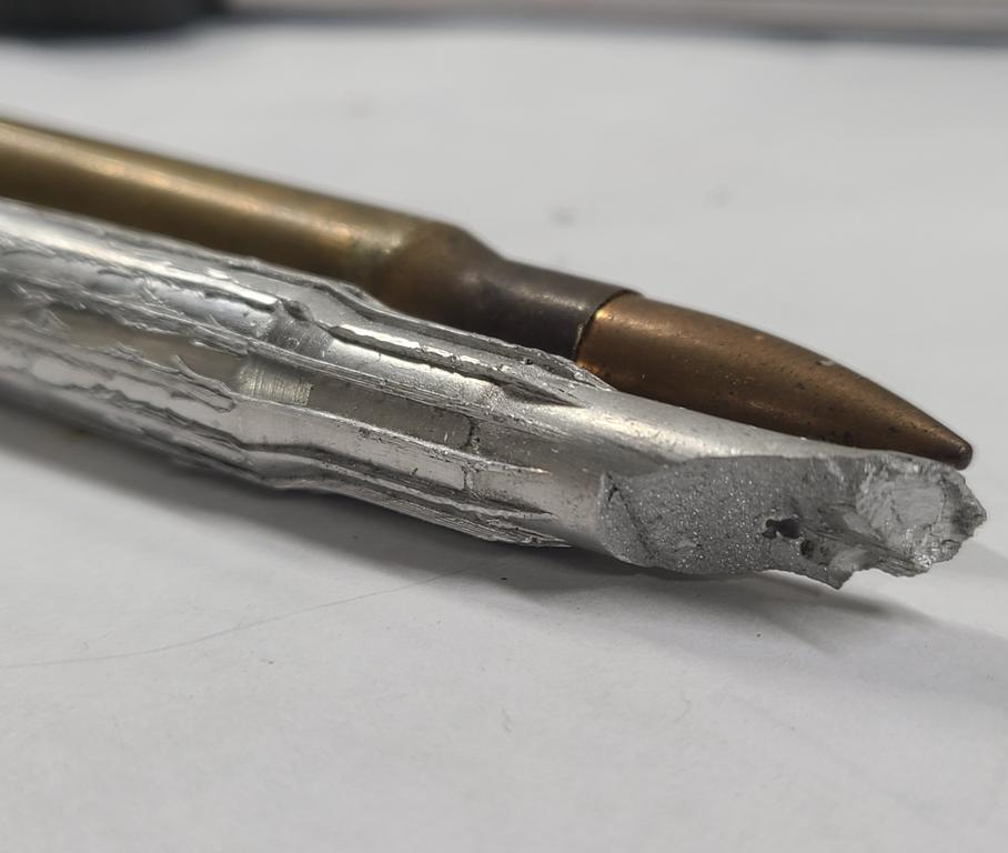

    Does anyone have any info on how Breda produced the fluted chambers on the 30-06 Bren conversion ? Someone that has one of the recent imported parts sets let me chamber cast the barrel and it has heavy fluting.

    Hoping to learn any history or manufacturing details on the gun.
    I am sure Breda engineers did it for a reason......

    But does anyone know how the fluted chamber was/is produced, i.e. with the internal flutes to the chamber? A "traditional method" of producing internal slots within a hole is to use a process known as "broaching" and in this application it is possible that all the flutes were "broached" at the same time or one flute at a time.

    I have broached a lot of things but doing a 30-06 chamber flutes would be a tough one. I don't see any room to press a long broaching to get the depth or room for chips.
    Hammer forging is not likely since the mandrel has to rotate with the rifling to remove and no way with straight flutes in the chamber.
    I think the stub I cast was dated 1959.
