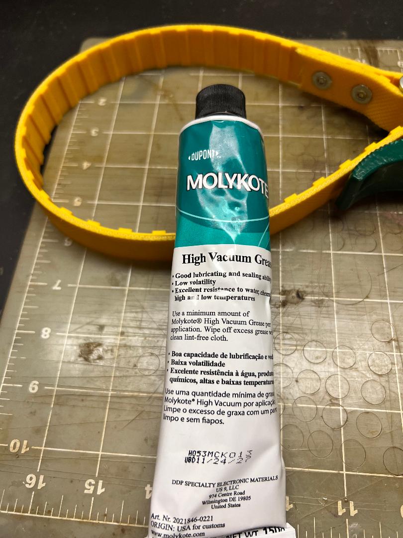

    Good Evening,
    Moving from dry to wet tumbling was the best move in case preparation. However, my Lyman was leaking like so many others and I tried using a strap wrench but still had leaking. Not happy with my purchase, I was ready to send it back. Then I recalled my days in a Biochemistry lab 40 years ago and found a solution.
    To prepare our glassware for the high vacuums needed in the centrifuges, we used the grease you see below. I am now tumbling some 50BMG for the T-Gewehr and 35 minutes into the tumbling, no leaks. Will see if the grease eats up the gasket, but I suspect all will be OK. Though you see the strap-wrench, I did not torque the lid too much. Randy

    I was using the Frankford arsenal wet tumbler and had a couple leaks to start. I wet the end caps before tightening and they quit leaking. Trying to tighten them dry is a problem.

    I have a Lyman wet tumbler. I always have a pot of food grade silicone grease around for my many corny kegs that suffer the same problem. Rinse the gasket well after each use, and then lightly grease it before storing.

    Yep!
    Food-grade Silicone grease or, since we are not eating the brass, the traditional "Rubber Grease", as used in water pumps and associated fittings.
