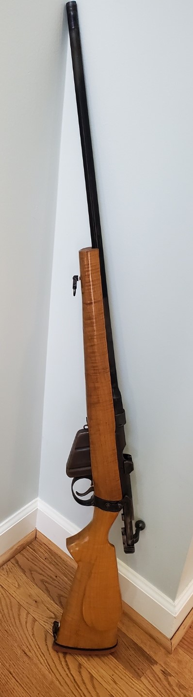

    A pic of the rifle as a starting point. Ugh, pretty ugly right now.
    I was able to get the front site base off with a soak in kroil and a bit of heat.
