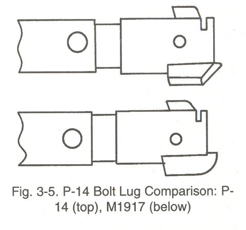

    Comparision of .303 and .30 bolthead , borrowed from Stratton.

    Thank you for posting the picture or diagram above. However, I am more confused than ever.
    I have two M-1917 Enfield sporters. I pulled the bolts on both of them and they both look like the top drawing with the lug angling towards the breech. The bolt body I was asking about is the same way too.
    So, I am a bit confused. Any other thoughts out there?

    Itook a look at three of my '17s and they look like the top picture.

    The drawing is wrong. The sharp angle belongs to the M1917.
