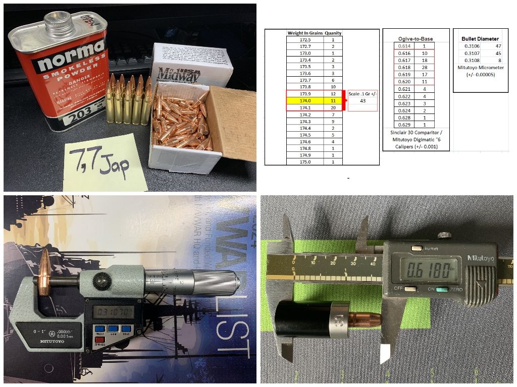

    I'm finally getting around to loading up some ammunition for the Arisakaicon Type 99 carbine I bought in March of 2023. It came with 100 once-shot Norma brass just needed some projectiles.
    I was looking around MidwayUSA and noticed they had Factory Second Bullets 303 Caliber and 7.7mm Japanese (3105 Diameter) 174 Grain Full Metal Jacket Boat Tail for $35.00 for 100.
    Being the couruios type, Aka Test Engineer, I am I wanted to see what the deal is with these bullets. I was curious about what makes them 2nds. Not knowing who the manufacturer limits what I can learn since I have no reference bullet or complete manufacture specification to compare what the projectiles are.
    So really, all I can learn is what the variance is;
    1.) In weight
    2.) In Diameter
    3.) In Ogive to Base
    And, of course, after working up a decent load, how well do the bullets work (out of my Arasaka)
    So far, I have learned:
    1.) Only 43 of 100 projectiles weight are within the advertised 174.0 grains (+/- in 0.1 Grain)
    2.) The Average Ovige is 0.618" (+/- 0.0001)
    3.) The Diameter is almost a 50/50 split 0.3106"/0.3107" and more than the .0.3105" advertised by MidwayUSA.
    So what does it all mean so far?
    • For enjoyment shooting (plinking), these projectiles should work just fine; how much they vary in the three measurements should have little impact on the accuracy of my rifle at my intended shooting distance of 100 yards.
    • These seem to be an excellent deal for the price, and I'm glad I bought two boxes.
    • I can't wait to see how these perform.

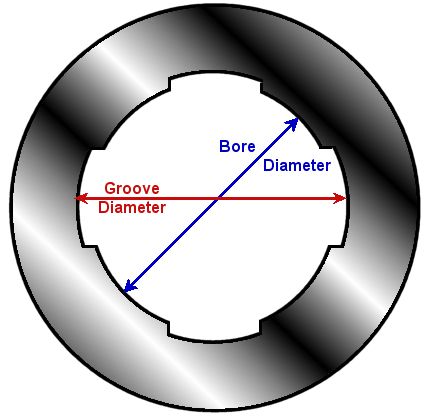

    "Not sure what you mean by "GROOVE""

    The military 7.7mm Arisakaicon bullet is right at .310 and the groove can be between .312 to .316 [ same for most .303's ] . The average WWII Britishicon .303 bullet is about .3095 . Both are bore riding bullets with a flat / exposed lead / hollow base to expand and seal the bore . With a small dia boat tail bullet accuracy is lacking , even at 100 yards . But in stock form with original sights it is very hard to shoot a t-99 Really well with about anything . In our 15+ years of every weekend military rifle matches we have great accuracy from most military rifle types , except the Enfield and T-99 . They just could not shoot on the level with the others and people quit shooting them , they could do about 3 to 4 inch 5-shot groups at 100 yards on demand , but in our matches that was not good enough for a win . . We had to hold matches just for them . But then again most people will not shoot at that level and will be happy with the results .

    I have some questions some of you may know and help many of us. First, I slug my T99 barrel and from the diagram, the diameter of my slug measures .3115". From the diagram above, this is the groove diameter and many refer this as the bore. From my measurements, the best bullet diameter should be .312 or .3125. Yet, I've come across other shooters that claim that a .308" bullet will expand to .312". Would this depend on the type of bullet? Would a Sierra bullet expand easier than Speer, Hornady, Winchester.. because of the lead core alloy? Or, are these shooters missing something that I just noticed? The groove diameter might vary but the bore measurement is the same, that is why a .311 bullet or .308 bullet can still be shot through a T99. By chance, the Speer .311 doesn't shoot well through my T99. Hornady is better. What bullets are used most on shooting competitions with Enfields and T99s? Sierra or Hornady?

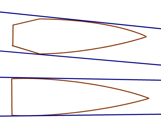

    1. It looks odd because it's "Metford" rifling, featuring rounded grooves.
    2. All those bullet brands normallly feature gilding metal (copper alloy) jackets with lead cores. Few of them expand on firing to fill the grooves - despite a lot of wishful posting on the web.
    3. Best results can be expected from bullets with flat base and not more than ~.002" under measured groove diameter.
    4. Boattail bullets offer less bearing surface than FB of same weight, making them a challenge in military chambers with generous throats. (They can yaw before engraving).
