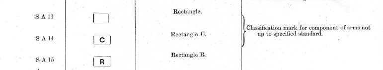

A friend has now provided a list of stamps used by the Ministry of Munitions where these marks appear
https://www.milsurps.com/attachment....72&cid=1&stc=1
Sub-standard barrels, but, apparently still useable for repairs. In July 1918 the Ministry buys another 4000 Rectangle R barrels at 11/9d ea.
Is there any idication as to why 3 categories of 'non-standard' was needed, or, what the difference was between each category ?
In 1916 BSA were supplying completed SMLE at 75/-
11/9 seems to quite a high figure for a 'reject' (not to specification) barrel.

Indeed - its just so tantalising that somewhere is a detailed explanation of who, why, what and when !
Originally Posted by
Mk VII
These marks were only for new barrels or also barrels salvaged from condemned rifles?
The "C" and "R" suggests the usual "cord-worn/cut" and "rusted" classifications.
Edward Bernays, 1928
Legacy Member
No, they were for the Ministry's inspectors, not the Army's working in the field.
