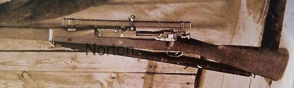

    I had to re-read your posts a few times to fully understand you .. so you have a M1903 from 1917 which has scope holes both on the receiver and on the barrel? You now bought bases and a scope.
    Are you aware that the "Grasshopper Mount" is in need of different bases than the "Mann-Neidner Mount"? The "Grasshopper Mount" is the original mount as Winchester has designed them, the mount is dovetailed either from front or rear to these bases and then affixed in place with a screw. The "Mann Neidner Mount" is an improvement (well, at least a modification) by eliminating the "Grasshopper" and using a different rear scope ring, additionally the bases are tapered dovetails and the mount locks on the bases simply by recoil. The bases on those two are NOT interchangeable. Additionally the handguard therefore also needs a different inletting to be able to put the scope on the rifle as well as to remove it.
    To be able to determine what you have pictures would be helpful. Already the location and spacing between the screw holes would be telltale as to what you are in need of.

    It sounds like you bought the wrong bases for the scope. You cannot use a set of Mann Niedner bases with the stock Winchester A5 scope with the grasshopper spring.
    As promo already detailed. The Marines used two different versions of the A5 sniper in WWI. The Mann Niedner used tapered blocks that have an internal plunger system and that scope does not require the grasshopper spring. The Springfield Marine blocks made by Winchester use a dovetail and thumbscrew design, with a grasshopper spring.
    What has confused people over the decades is you have two very distinct rifles being run during WWI.
    If you have a grasshopper spring on your A5 scope you will need a different set of bases than the Mann Niedners. The standard A5 scope used by the Marines in WWI used bases that were called the Springfield Marine by WRA. Those are basically hens teeth and impossible to find. The Unertl O & E are very, very close and would work, as long as they have the hole drilled in the side of the block for the WRA thumbscrew.
    The spacing of the drilling and tapping of the rifle between Mann Niedner and Winchester Springfield Marine are totally different as well. The blocks are not interchangeable. So if you rifle is already drilled for one or another you need to figure out what spacing you have first. If you post pics I can tell you. The handguards between the two are totally different as well.
    You mention something about a change in markings on the scope from WWI and WWII? I'm not sure if you know but WRA sold the rights to their A5 scope to Lyman and Lyman made a copy after about 1928. Maybe that is what you mean?
    But here are the two rifles used by the Marines as sniper rifles in the WWI era, both pics were taken in Franceicon in WWI.
    This is the WWI Mann Niedner. It used a tappered block design with internal spring plunger to tighten up the scope.
    This is the standard A5 scope with the Grasshopper spring on WRA Springfield Marine bases taken in France around December 1917. Winchester built these rifles for the Marines after the Marines fired Adolf Niedner in early 1917.
