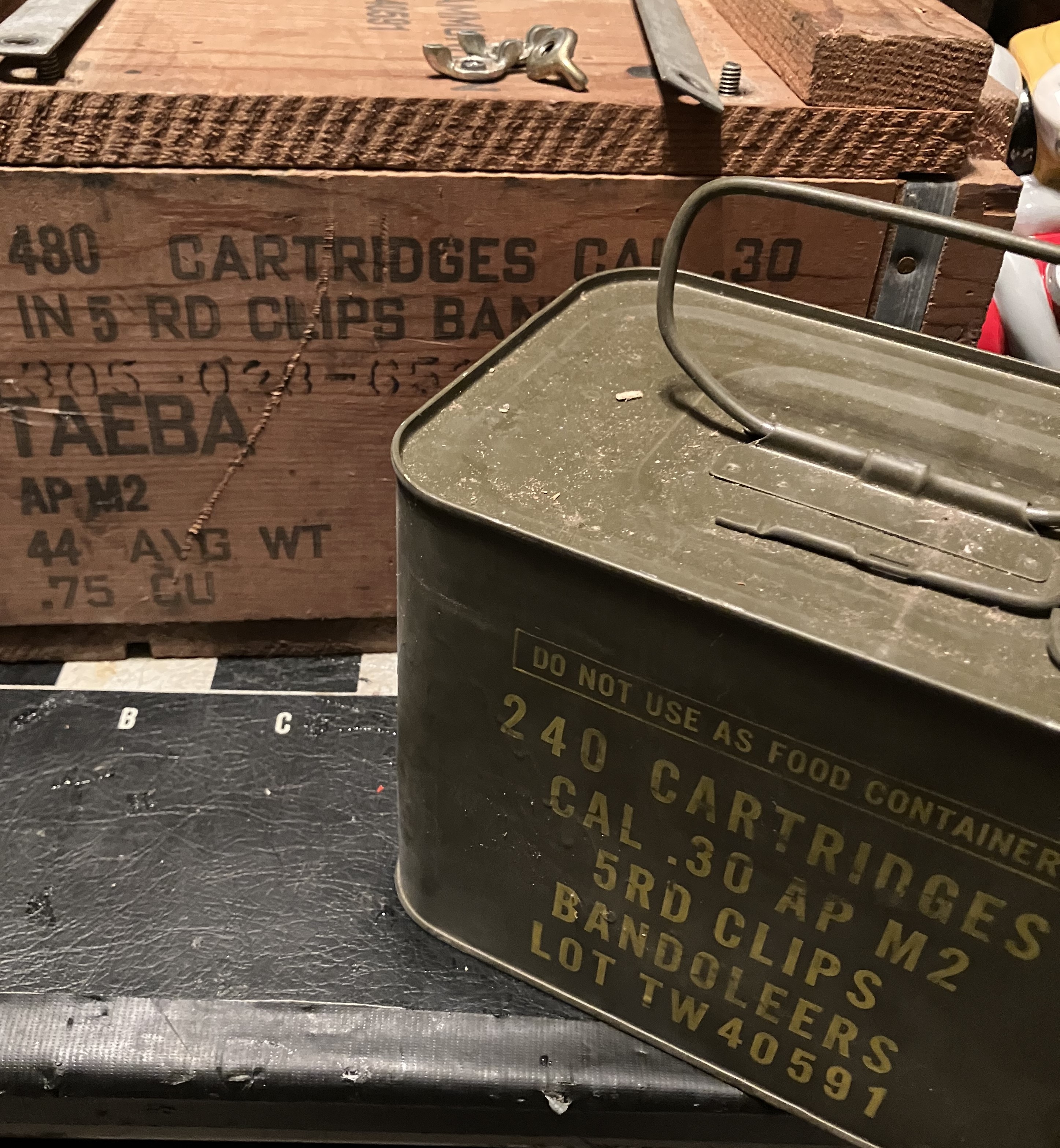

    id some 30-06 plz
    no date stamps found on crate or cans, any heads up would be great!

    US Production from Twin Cities Army Army Ammunition Plant, Cal .30 (30-06 on 5 rd charger clips for Springfield models and M1917. M2 AP is Armor Piercing - bullet tips are black.

    I'm thinking the date will be incorporated into the stamping on the case. If you give us a bit clearer picture of that?

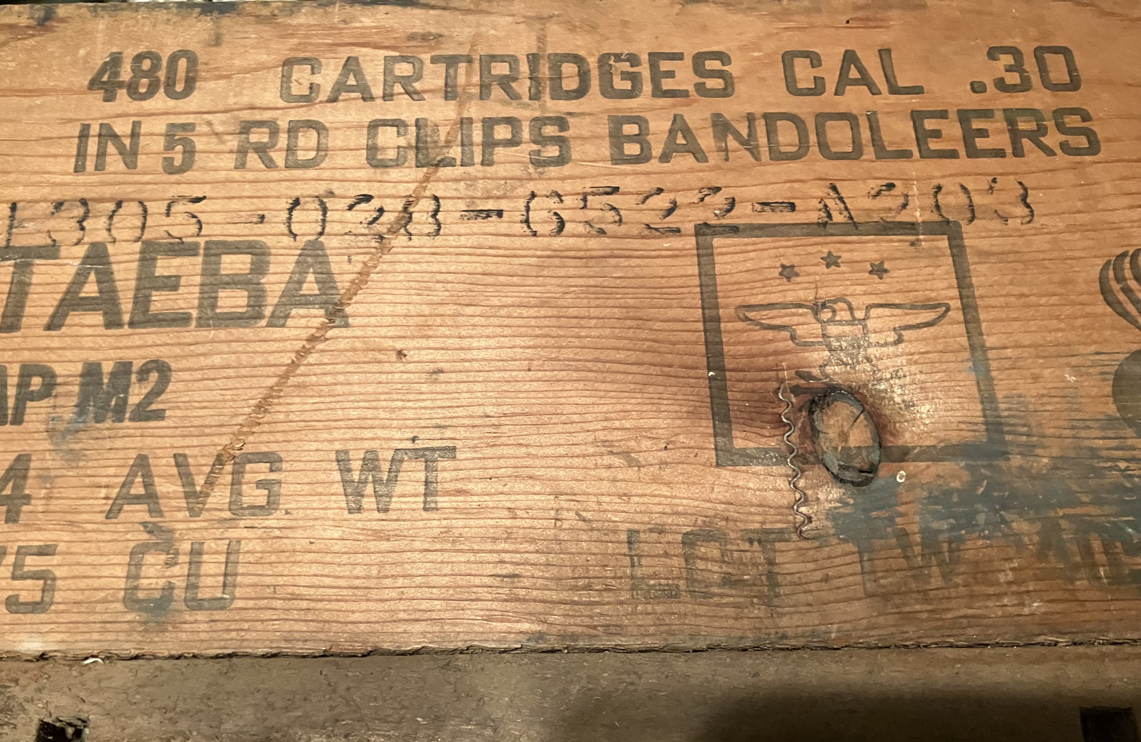

    thanks again!

    Bottom right of the last pic, lot number TWXXXX, the year should be the first two digits. TW64? What is it? You may need to do some interpretation by turning the box to an angle or using a bright light.

    yes sir mr jim, i didnt think about taking a pic of the top lid of the crate
    plain as day marked tw 40591.......

    The following are my observations from years of interest in US Military Small Arms Ammunition headstamps, lot cards, box descriptions, shipping crate info and US Stock Codes. I am NOT an expert.
    - Your ammunition is cal .30 AP on 5rd chargers. The plant of manufacturer is Twin Cities Army Ammunition Plant. The headstamp is TW and a two year date.
    - The last WWII lot of .30 AP was TW 40064. Your lot 40591 is after that. So it appears that your ammo is of post WWII production when Twin Cities was re-opened for Korea.
    - Twin Cities was a WWII Government Owned Contractor Operated War Emergency Plant. It was closed after WWII to be reopened for Korea then closed again to be opened for Viet Nam.
    - The US Military, for the most part, did not include date of manufacturer on cartridge boxes, crates, lot cards and Ordnance Corps item codes until well after WWII.
    - Your crate shows two government item code systems. The first is the Ordnance Corps Item code of the WWII period of TAEBA. The WWII era code as I recall the T was for small arms ammunition, the next letter was caliber, the next bullet type and the last internal packaging type and qty. At that time the year was not part of the lot number as it is now.
    - The long number printed in black is the NSN or National Stock Number. So it appears that your wood crate was manufactured on the WWII stock system then relabeled for the NSN system. So no exact date of manufacture clue here.
    - Side note: TW did not start the conversion of .30 AP to non-corrosive primers until Feb 1952 on lot number 19776. The years of 1952, 1953 and 1954 are a little uncertain for non-corrosive primers in .30 and .45. Most research seems to agree that corrosive primers were used after the date of first use. A sure date (non-corrosive by headstamp) is 1954. Some Match and International Match lots are corrosive in the mid 1950's.
    - So will this ammunition fire? Since it is in sealed cans and a US military primer formula that is known for long storage life (corrosive and non-corrosive) I am sure it will fire.
    - Sorry that I cannot ID the date of manufacture and thus the corrosive nature of the primer.
    A deep dive on the net for TW lot numbers may solve the question. However, if you decide to open a can the head stamp will tell the story.
    Hope this helps, Steve762
