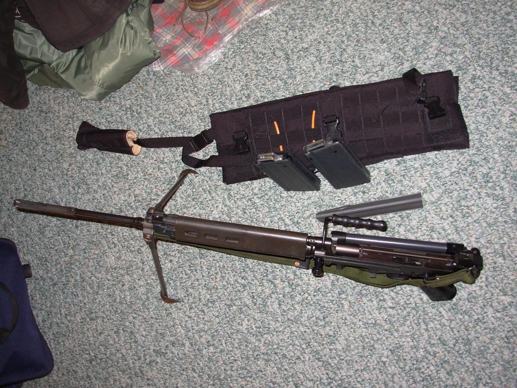

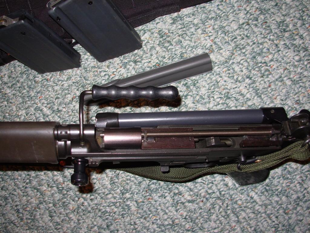

    im "bumping a thread" .............geeze ,
    anyway , i thought it worthwhile to post that i got my lit , installed it , took it to the range ,
    please forgive the bad photos , its still cold here these days , the kit installed -
    and my target at 50yds , the one on the right was first round down the tube for function , the rest are rapid fire 10 , not one hickup ,
