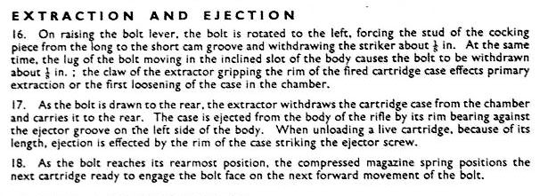

    Without bolt and lug compression and resulting recovery actions with poor primary extraction would have a difficult time extracting the fired case. Its a basic principle known since the bolt action rifles first appeared on the scene.
    The taper of the .303 case body was likely meant to take advantage of this, since theres not that much of a shoulder there even after fire forming.
    The Enfields have a far less effective camming action than other turn bolt rifles of the day. Theres so little primary extraction that a cock on opening conversion isn't likely to work. the cock on closing action allowed easier opening.
    It occurred to me that some might not realize just why a non rotating bolthead of the Enfield and Mannlicher designs or the non rotating extractor of the mauser style and Kragicon designs is necessary for turn bolt actions of high powered rifles.
    The fired casings are firmly pressed into the chamber and seldom can be turned in the chamber by the bolt. Without primary extraction the case would be extremely difficult to extract under the best circumstances, and without the spring back of the compressed lugs or bolt body to break the adherence of the case to the chamber walls turning the bolt to engage the camming surface would also be very difficult. Both the non rotating extractor claw and camming surface are necessary, the case isn't going to just jump out of the chamber by itself. If nothing breaks the grip of the case to chamber adhesion then turning the bolt would be several times more difficult.
    The springyness of the Enfield action in this way greatly makes up for its relatively weak primary extraction.
