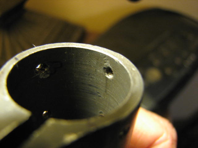

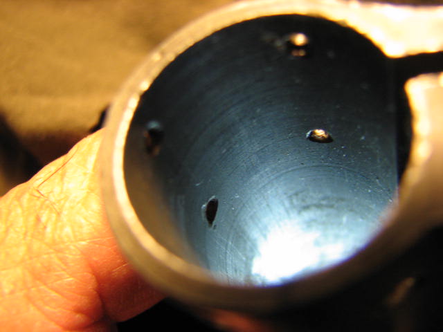

    Photos of the inside of the adapter -

    Quote Originally Posted by Madcap View Post
    those look to have a chamfer for part of the head to reside. When bucking a rivet, the shank will expand and "flow" to fill the space and tighten the joint provided it was clamped together tight. insert rivets from inside. tap in a slightly tapered mandrel to hold it the rivet extra tight in the hole, and peen over the head from the outside. when you drill the hole in the shield, be sure to bevel it well...like a flush rivet on an airplane. when you grind it smooth, it will become as perfect as the circle and the bevel will give it enough meat to hold. That's how I did my krag handgaurd clips. much thinner metal than your shield, but a slight chamfer was enough. now, a hand guard clip doesn't have to be as strong as your heat shield, but same principal I think. When tapping the rivet by hand, you can tell and feel how tight the joint is becoming by the sound of the hammer. On the hand guard, tops on my test pieces would gradually increase in pitch until "pop" the wood split from the rivet expanding.
