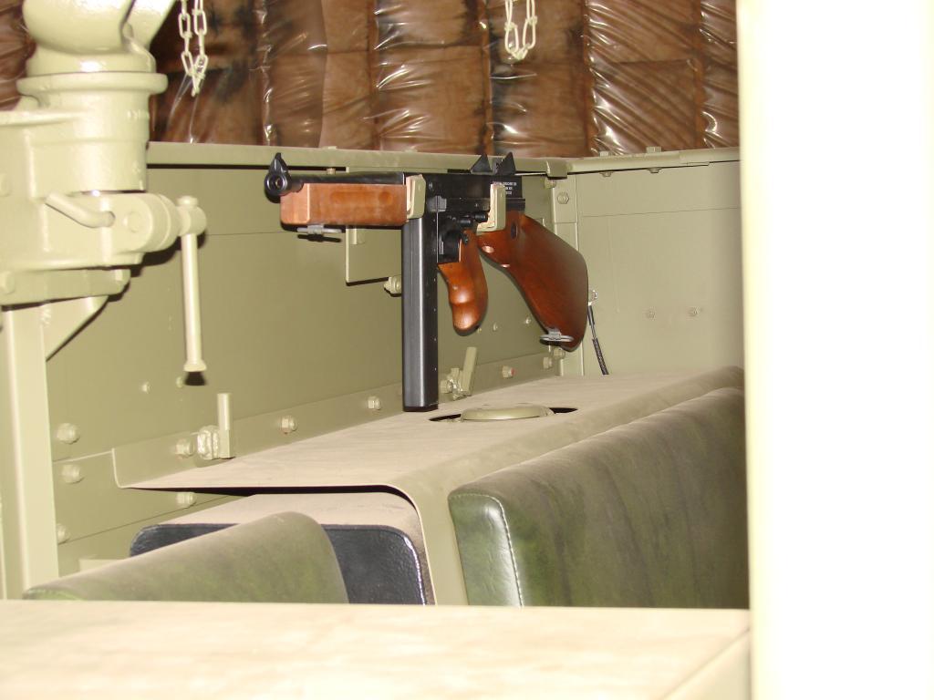

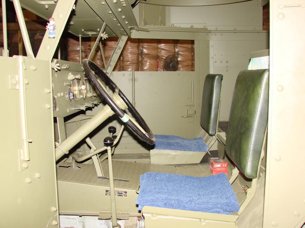

    Been a bit. Still slaving away on her. Took a while to do the floors, nothing lined up so trim here trim there. Also got a french speedo installed for now, its different looking but fits well and works
    Hood sections were a huge pain installing
    Back rests on seats are on too
    And the tommy in its new home
