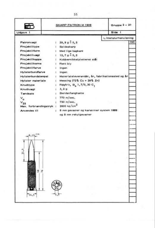

    Here's the original data from the Danishicon arsenal. I have only added this one pic the rest is avaliable in my Photobucket album with public access.
    Data:
    Bullet weight = 12,7gram~196gr
    V0 = 770m/s~2525fps
    Max pressure = 2600bar~37700psi
    Krag-Jørgensen 8mm cartridges from the Danish arsenal
    If you want any additional info or translations then please ask and i will deliver
