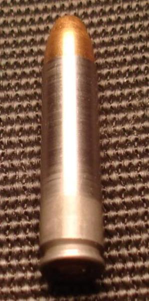

    Some of Wolf's polymer coating gets left behind as each round is fired and it builds up in the chamber of my M1icon Carbine. One day before I was aware of the build up problem I was running my third box thru it without a stutter until the carbine failed to eject.. I could not retract the op rod by hand and finally got it open using a mallet..This is when I discovered the build up problem. It also told me the extractor was getting a work out. I won't buy anymore Wolf Carbine ammo but will use up what I have left but now I remove the polymer coating with a 3M pad and an electric drill. Here is a pic of what it looks like removed. I left some on the base for comparrison but normally I remove all of it.

    Shooting Wolfs .45's in SA Thompson.After 4 shooting boxes I discovered the compenstor slots were cloged with hard soot or residue.When I cleaned it I had to chisel the residue from the slots.No more wolfs for me.For some reason I don't have this problem with Remington or reloads.
