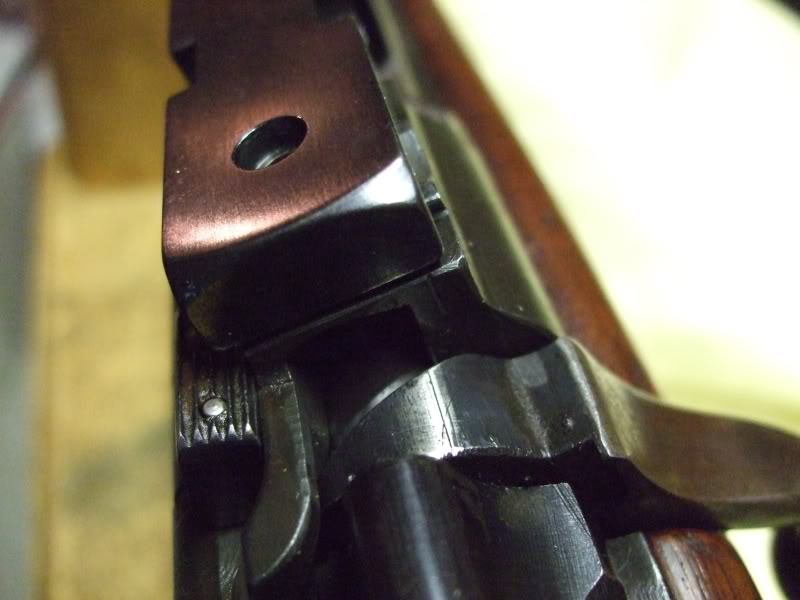

    Fortunately the Weaver mount on the rear of the receiver was offset by a gunsmith who knew what he was doing. I assume that won't present too much of a problem mounting a Redfield Base if I can find one. Thanks!

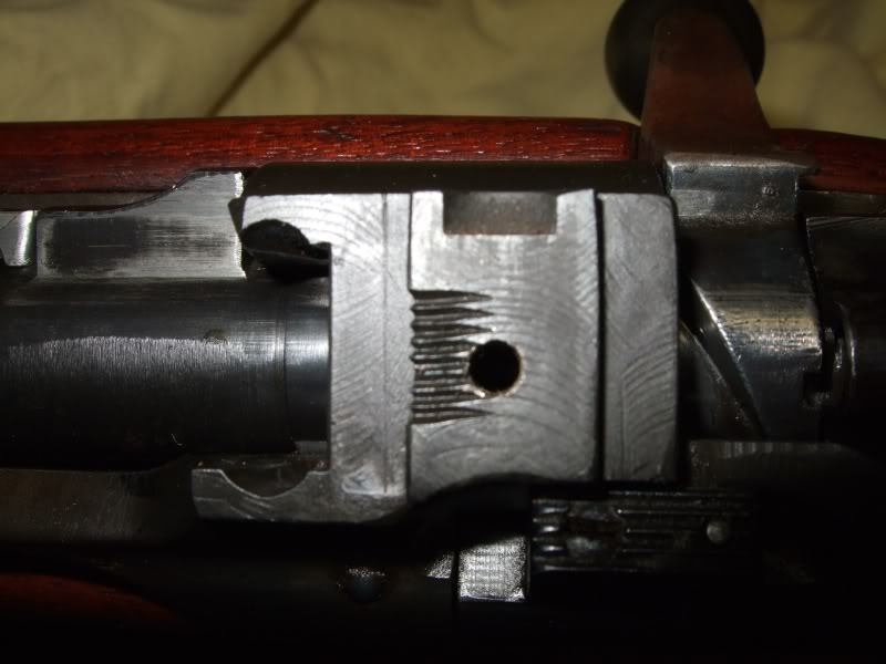

    I'm especially pleased to stumble across this thread. I picked up a sporterized A3 awhile back for the CMPicon sniper match that had Weaver rings mounted. I was dismayed when I found the rear sight hole had been drilled a bit off.
    It produced an offset scope mount by this much
    I'd be very interested in chuckindenver's thoughts on the likelyhood of a successful mounting using this hole.
