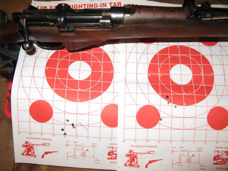

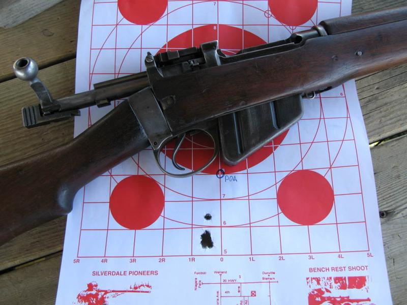

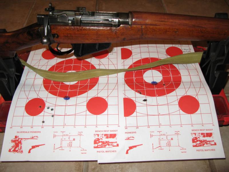

    Well folks, I finally got a camera so that I can show you some pics of my groups.
    The first picture shows a typical grouping from my Jungle Carbine at 50yds benched with 24grains of IMR 3031 shooting a Lee bullet sized to .311 calibre. This load was getting about double the group size than what I was getting from my SMLE and #4mk1.:
    Since the bore looked very good on this rifle, and the groupings on my other rifles were also bit larger than I'd have liked, I decided to load a few more cartridges without sizing the bullets (gas checks were pushed on by hand) to see if it was a case of my shooting undersized bullets in an overly large bore. Here's another group from the same rifle taken last weekend at 50yds benched:

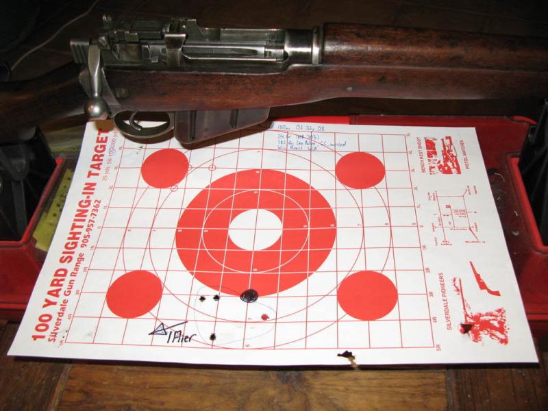

    This newly discovered accuracy motivated me to sight in the rifle at 100m, where I got the following group from a bench. Note the arrow pointing towards a bullet that shot low and to the left just off target. When I fired another 5 round group with the rifle sitting, I got a slightly larger group than the one pictured below, with two bullets shooting to the left and one of them also a bit low. Perhaps some further practice will confirm whether this was merely a coincidence or part of a consistent pattern, (i.e. a changing POI as the barrel heats up.....AKA the infamous wandering zero?):

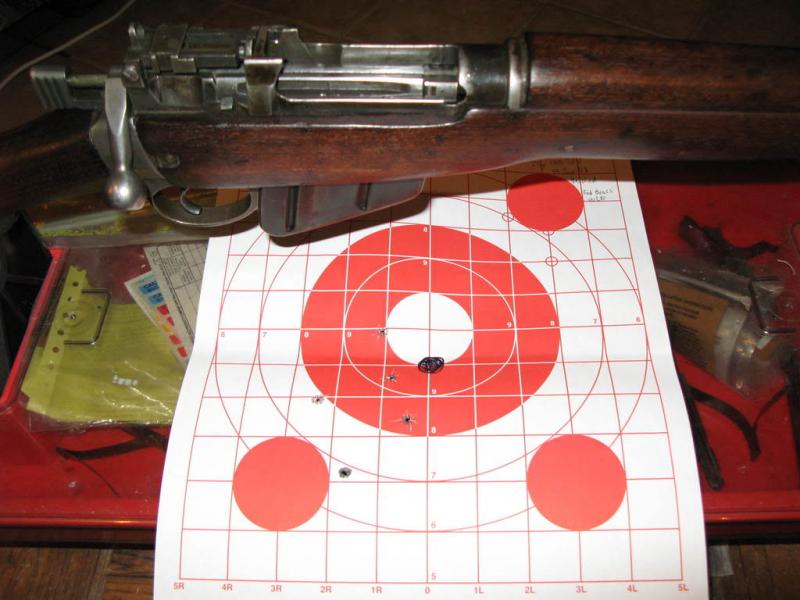

    Below are two groups from my Ishapore SMLE. It used to shoot about 3" to the right consistently, and boresighting confirmed that it was due to the sights being off centre. The front sight has since been drifted to the right. These two groups were taken at 50m benched with a load of 24grs IMR 3031 using the sized ammo (another group taken at the end of the day with the unsized bullets showed similar if not a tad bit better accuracy):
    I might still have to move the sights a tiny bit back to the right since the rifle now seems to shoot about an inch to the left at 50m. It was good enough however to move to the 100m firing point, and after making some adjustments for bullet drop, I fired managed a 5 round group from the sitting position at 100m. While I grouped all over the target, I am confident that it was more due to lack of practice than any deficiency on the part of the rifle and load.
    My #4mk one has produced groups similar to the #1mk3 with the sized bullets, though I've found that they often don't feed well from the magazine but get caught in the process. Any suggestions?....and yes, I did load the stripper clips properly! Here's two groups fired from 50yds benched; the second group was hindered by loading problems that caused me to raise my head and adjust the rounds (note the two pairs of bullets that are touching/nearly touching and separated by a longer distance).
