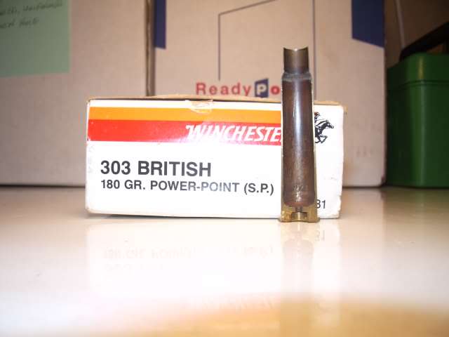

    Below, .303 Britishicon once fired Prvi Partizan case on the left and Greek HXP case on the right, after checking and measuring 100 Prvi Partizan and over 500 Greek HXP once fired cases I was very surprised. The Prvi Partizan and Greek HXP once fired cases had NO stretching or thinning in the base web area after firing. This means NOT all types of cartridge brass are created equal and American commercial cases stretch more than some other brands.
    Bottom line, military cases are generally made thicker in the base web area BUT the quality or brass mixture also plays a big part in case life.
    Please notice above that the Prvi Partizan brass is larger in diameter and also thicker than the Greek HXP cases, and the HXP case expanded more in diameter. The point here is though neither type cases stretched or thinned in the web area when fired.
    A once fire American made Winchester case fired in the same Enfield with the same headspace setting (.067) the Winchester case stretched .009 in the web area.
    Military designed and manufactured cases are made to shoot in long fat chambers, commercial cases are designed and made to shoot in smaller shorter chambers and can cause problems in military chambers.
    Below a case in point, the 7.62 NATO case did not separate in the 30-06 M1icon chamber.
    Headspace is governed by the cases you shoot and NOT the rifle.

    My Enfield Rifleicon headspace of .067 didn't change BUT the head gap clearance can change depending on rim thickness. Head gap clearance is the air space between the rear of the case and the bolt face. On the Enfield rifle this can be as much as .020 (twenty thousandths)
    American SAAMI commercial .303 Britishicon cartridge cases are NOT made to British military standards and this is why short case life is a problem if the cases are not fire formed properly.
    The head gap clearance with my Winchester cases was .009 and this is how far these cases stretched and thinned in the web area when fired.
    The main point I was making was the Prvi Partizan and Greek HXP cases did NOT thin or stretch in the web area when fired in the same Enfield rifle.
    My statement "Headspace is governed by the cases you shoot and not the rifle" simply means not all cartridge cases are made or constructed the same.
    From my testing and taking case measurements I would put the .303 Prvi Partizan cases in the same category as American military Lake City brass and much thicker in the base web area.
    I use a rubber o-ring to fire form my cases.
    When the o-ring fire forming method is used the rubber o-ring centers the case in the chamber and holds the case against the bolt face and the cases will not stretch and thin in the web area.
    In another forum one member did a destruction test after using the o-ring fire forming method and got over 30 reloadings from his .303 cases before the first neck crack happened. (NO case head separations)
    I do understand what the thickness numbers on my headspace gauges mean and where the front and back of the gauge rim touches when used.
