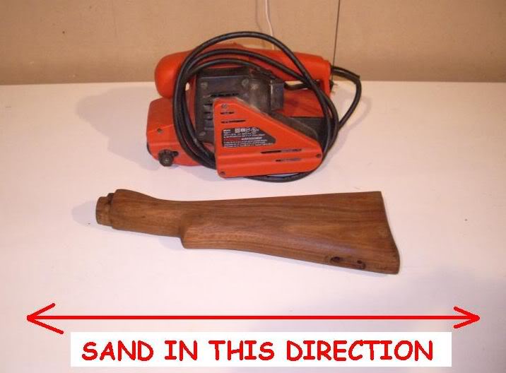

    Now listen for the sound of "ZF's" being quickly scrubbed/linished from buttstocks around the world...
    Remember sand with the grain of the wood
    (if the wood smokes your pressing too hard)
