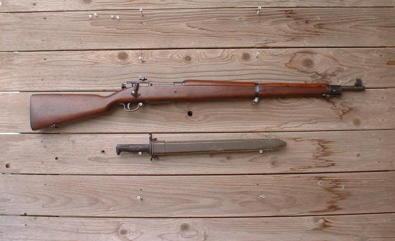

    if you look at the picture, you can see the dark area were the cut off was welded.
    common of a recovered Drill rifle
