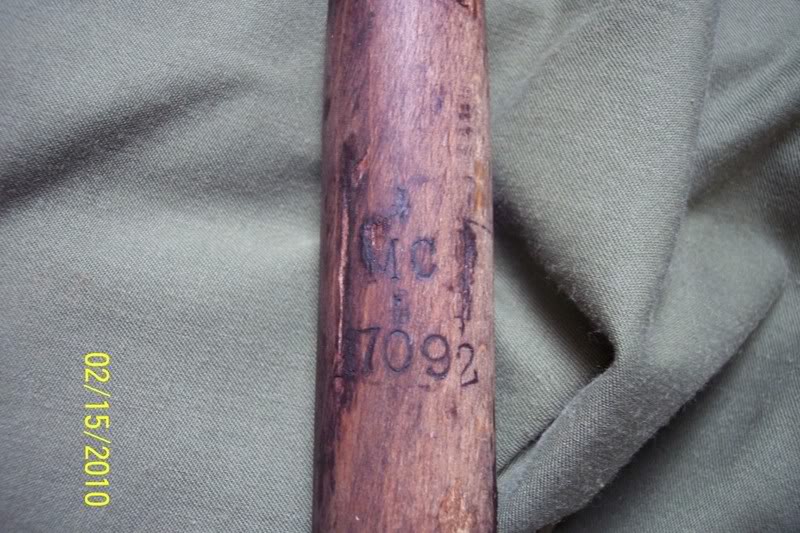

    Anyone know what these mean:
    Got 2 nice little crack to fix ~ I think I will use Gorilla wood glue then clamp with some surgical tubing

    The magazine looks as if it is from a SMLE.
    It could be one of the BSA conversions from 1942-43 where the No1 (SMLE)mags were converted to suit the No4 Lee Enfield Rifleicon.

    Don't bother gorilla glueing that split butt down the heel butt plate screw as it'll just open up again. Patch the butt as per the photos regularly shown here. Can anyone pull up a photo of a suitably Armourer patched butt to illustrate to Chunky
