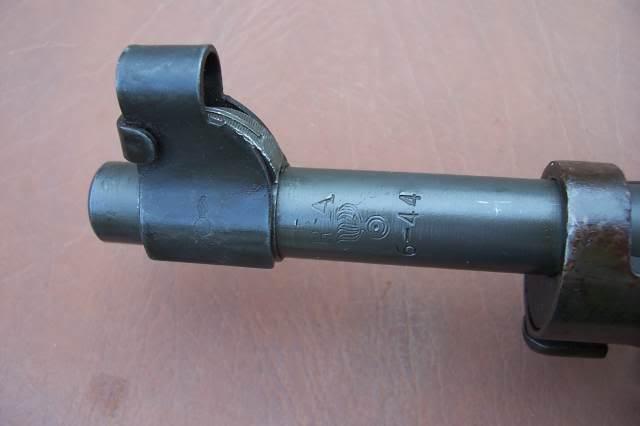

    so you understand what {out of index is}
    though this rifle isnt a 17 it is a 1903, and set up the same way.
    if you look, the front sight is canted off to about 1:00 with the rifle at 12:00
    then the closeup of the witness markings on the side of the receiver,
    they are pretty darn close,and look to be on the money with a fast look, but a close look you can see they are off just a bit.
    setting the rifle in a action wrench and vise, backing the barrel out, then re setting the marks is all thats needed to repair it correctly..
    to check the index on a 1917 or P14, the witness mark is on the bottom flat of the receiver ring. just look, id bet its off just a bit.
    molinenorski@msn.com
