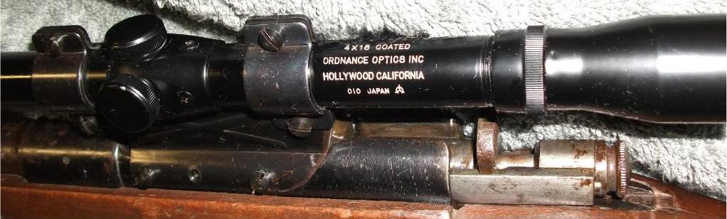

    "Quick" photo or two regarding previous query. Of course, technically it's NOT a "real" sniper rifle. "Oswald Special" duplicate :
