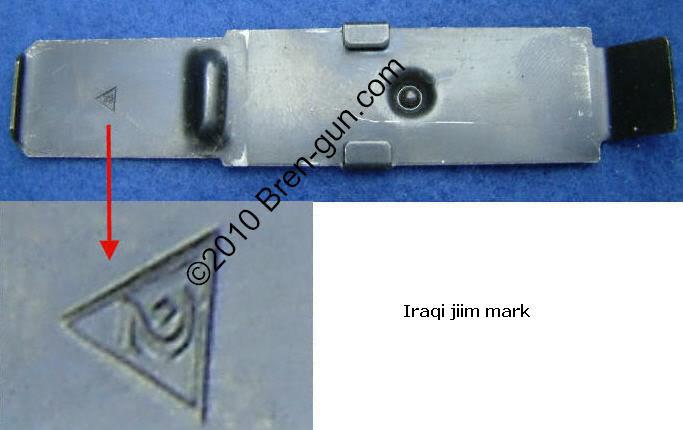

    Bulgaria ordered the Czechicon made 'Model 1939 Bren' (zb39) in 8 x 56R Mannlicher in 1938.Other contracts for the Czech Brens built to customer countries specifications (so they vary a bit in barrel ,sight configuration etc) in .303 were Iraq and Ireland that I know of with Egypt and Latvia also mentioned in Czech records.
    My only item of Czech Bren parts for Iraq,a magazine bottom plate
    Peter you mention that the oval firing pin was a UKicon design but SAC Minute 1544 quoted in Dugelby's Bren Gun Saga seems to say this was a ZB design ?
    ATB Kevin

    That's interesting KG. I'll look it up on Tuesday! But the trials distinctly report on a vast amount of stoppages due to caps out and initially it was put down to using old stockpiles of 1918 ammunition. They reported back to the factory with their oval punch type fiting pin and ZB initially tried the staked cap as an answer. That's interesting about the odd ZB39 calibre. This whole thread's turned out to be interesting in fact.
    We have some captured Iraqi Sten guns and No2 revolvers and they all seem to have a similar triangle mark but with a squared-off figure 8 set inside it with the squared off top of the 8 almost forming the top of the triangle
