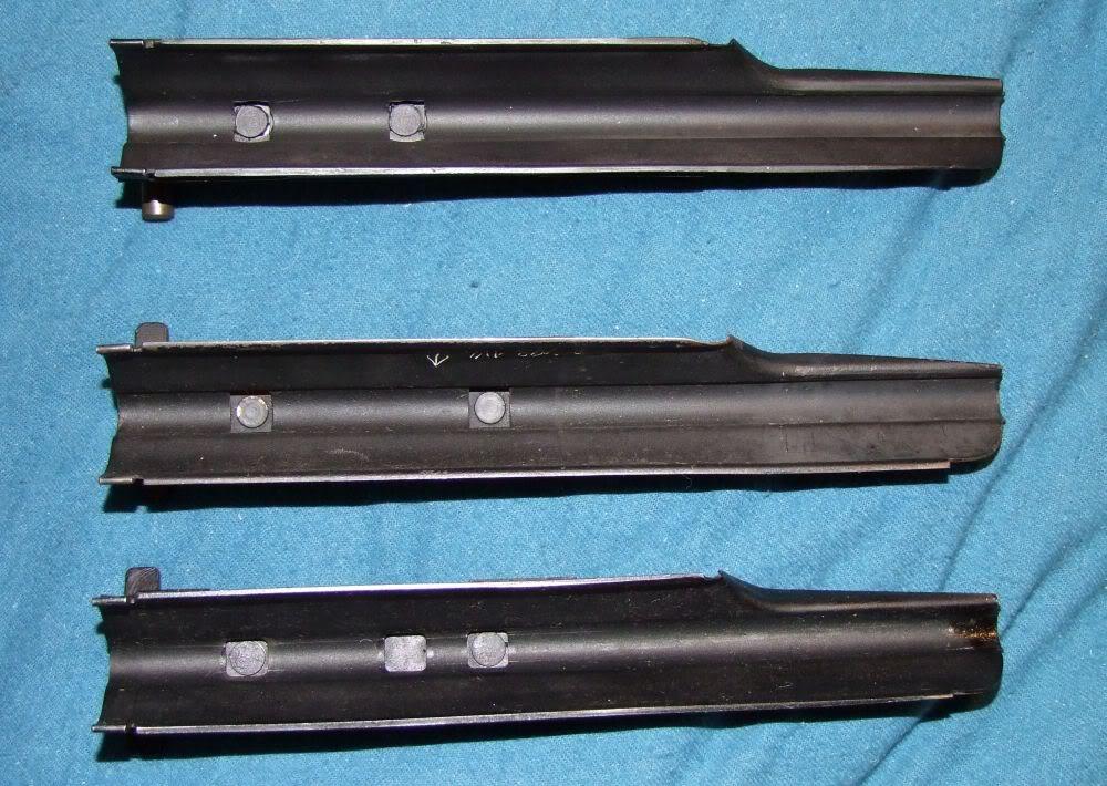

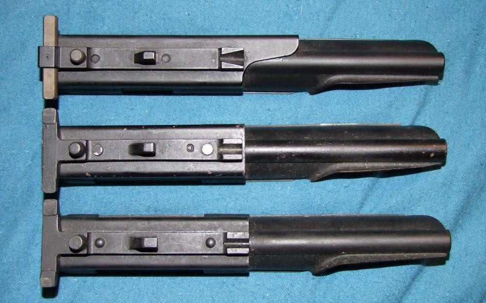

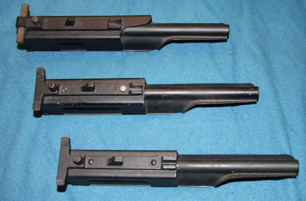

    Here's a selection of Trilux mountings.
    Top: 1st Model
    Middle: Standard model marked in white paint on the inside CR 193 AVL /|\
    Bottom: Late production, Manroy Engineering. (thanks PJK for conformation)

    You will observe on the centre phot of NZicon's post that there is a C moulded into the actual bracket. This denotes a CASTING for those who are unaware. This marking will be encountered on many Brit Military spare componants.
