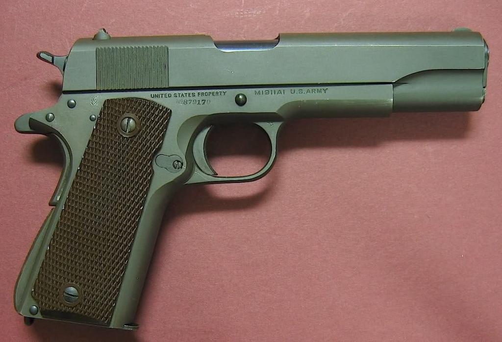

    The Swartz cut in the commercial-marked WWII Colt slides used in the 930-935K serial range is standard. The Swartz cuts were made in both the slides and the receivers prior to the external markings being applied. So all the commercial-marked slides transferred to military use in 1942 and 1943 had the Swartz cut in them.
    There are several variations of C/M transfer pistols with different parts transferred. I think the lowest numbered WWII Colt receiver I've seen with an S-marked C/M recevier is 798021. I suspect the highest is about 890-900K.
    I've only seen (2) WWII Colt receivers outside the C/M re-numbered range (860003-ca. 866700) with a Swartz-cut receiver that was NOT re-numbered. One was a Britishicon commercial-proved piece in the 90x,xxx serial range. The other is 872308 that I have. From the outside, both of those pistols look like standard military pistols. It sometimes pays to look inside pistols that are otherwise plain-jane-looking.

    This one has the S marked receiver and barrel, but G marked slide, with no Swartz cut in receiver. The S marked barrel has what appears to be heat blue in the area where the commercial barrels would have been polished back to bright, almost as if they heat blued this area rather than dropping the barrels in the Du-Lite tank to blue the chamber area.
