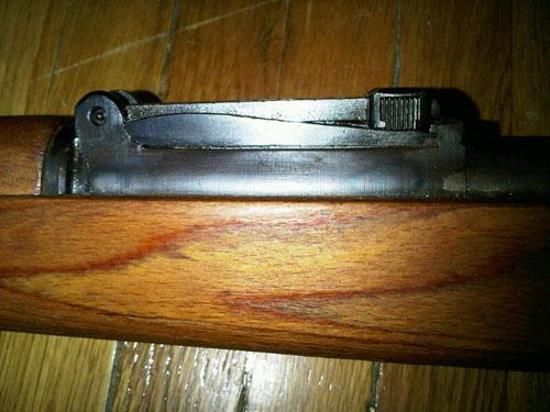

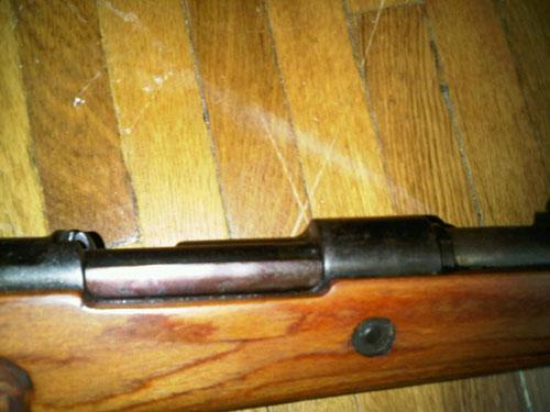

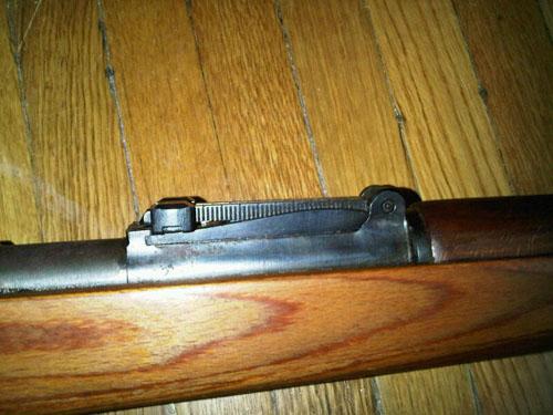

    You seem to have a fixation with the bolt - 4 different photos of the same thing, also several other duplicates. Multiples of the same thing do not tell us anything and are of NO help answering your questions.
    IF you would post photos of both sides & top of the rec and of the left side of the bbl there is some possibility that your questions can be answered.
    What you have is a K98kicon rifle, based on what I see, I would guess it is a Yougoslav post war rebuild, But ----?
    Sarge

    Quote Originally Posted by avroe View Post
    so would the correct name for this firearm based on the receiver be a "1939 Code 42 K98kicon (Mfg by Mauser Werke AG, Oberndorf a/N)" with a ton of random parts? or would this be considered a "Model 98" as I was told by the person I purchased it from?
    I'm getting a little confused as to how to even call it now. haha.
    Based on these stampings, does it make sense this firearm probably passed through israel at some point?
    I would call your rifle a scrubbed 98k meaning most of the markings have been removed and the bolt is a total mismatch being a straight bolt. Like has been said a post war rebuild assembled from a conglomeration of parts. The barrel bands are stamped and welded, late war German production. The parts which are stamped with WaA 63 are probably Czechicon wartime production as this inspector number was assigned to Waffenwerke BRUNN around 1940 before that WaA63 was Oberndorf A/N, the main mauser works in Nazi Germany. There should be a series of numbers and letters on the barrel called the barrel code and Mauser experts(not me) can tell where and when the barrel was produced if it is German production.
    Check the headspace and bang away, should be a decent shooter.

    Quote Originally Posted by mike webb View Post
    There should be a series of numbers and letters on the barrel called the barrel code and Mauser experts(not me) can tell where and when the barrel was produced if it is Germanicon production.
    Where on the barrel might I find this? Will I have to disassemble it to view this part of the barrel?
    I appreciate the help. I'll be taking more photos as requested when im back in town.

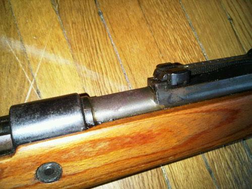

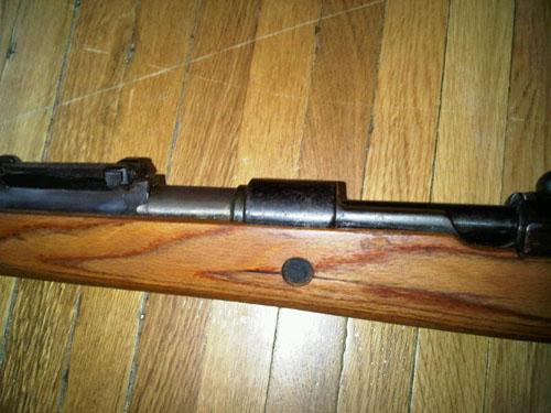

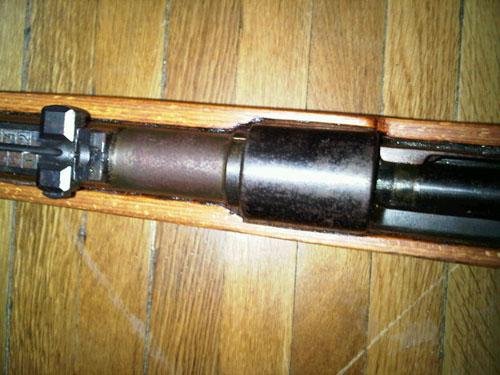

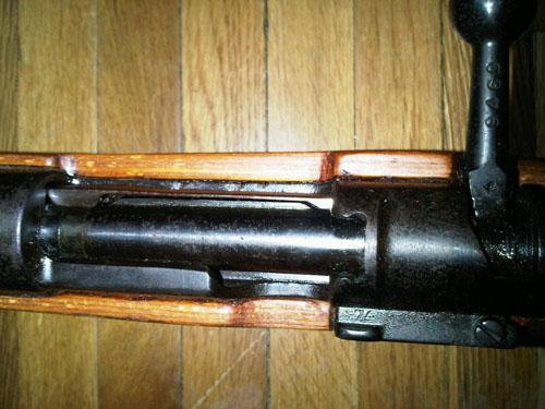

    Thanks for all of the great feedback.
    I've added a couple of more photos per the requests above.
    Sorry I hadn't included photos of these sections before, and I appreciate the help.

    Looks like your barrel code was scrubbed as well unless it is a Yugoicon rebarrel. The barrel code was usually stamped just ahead of the receiver ring at right angles to the barrel, sometimes partly below the wood.

    Was it common to scrape the barrel code like this on the post-war rifles leaving Waffenwerke BRUNN?

    I have never seen or heard of bbls being scrubbed except for the Beschutz being punched.
    My guess is an unmarked post war rebbl job.
    Sarge
