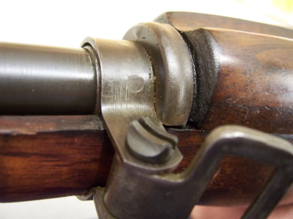

    Unscrew the barrel band screw lose enough to move the band, depress the band spring and slide the band forward. Once you have done this the hand guard will come off and then lift the barrel up, out and forward out of the stock. You can then push the trigger housing pin out and the trigger housing will slide back or forward to remove. That will allow good photos of the hammer strike are on the top of the trigger housing.

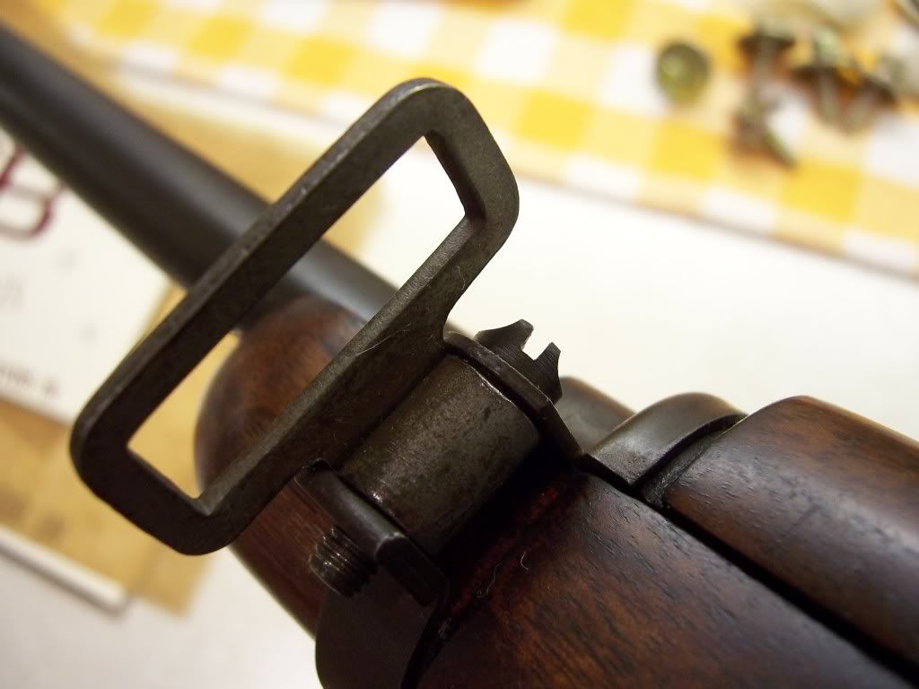

    Take a close up pic of this area noted on your pic. This pic seems to show a stake mark from a latter type sight being installed

    I've got bad news for you, that had a adjustable sight on it at one time and your "new" flip sight is most likely a reproduction. I can't say for sure about the band because I'm not very good on IDing fakes on them.
    It has also been refinished at one time. The buttplate also looks new to me. I'm not saying this is now a piece of junk, but it is worth around $750-$1000 instead of $4000. It is still a nice looking carbine.

    Thanks for all the information. I will contact the seller about these issues. I bought this gun for the historical aspect and maybe something to shoot every now and then. Does the whole thing look made up from various parts? thanks

    Yes it does. He can tell you what he wants, but there are many details on that one that say restoration from parts.
