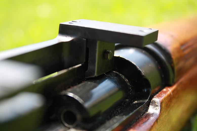

    There was also a report on the feasibility on using telescoped No8 rifles to be used for indoor sniper training. I'll see if I can't find that too
    That's very interesting as I have a bracket for my No8 that’s NZicon marked.
    I spoke to one of the NZRAF armours who said he had never seen anything like it but suggested that it could have been set up by the army for sniper training?
    The bracket simply bolts to the two standard threaded holes in the side of the receiver and has a clamp at the front, on the top of the mount there are threaded & doweled holes that I guess the scope attached to (don’t have a scope or the other parts).
    At one point I fitted a weaver to it and it work very well, but I would like to know what scope was used with it originally maybe a ZF69 as I have an ex-NZ army one of those.

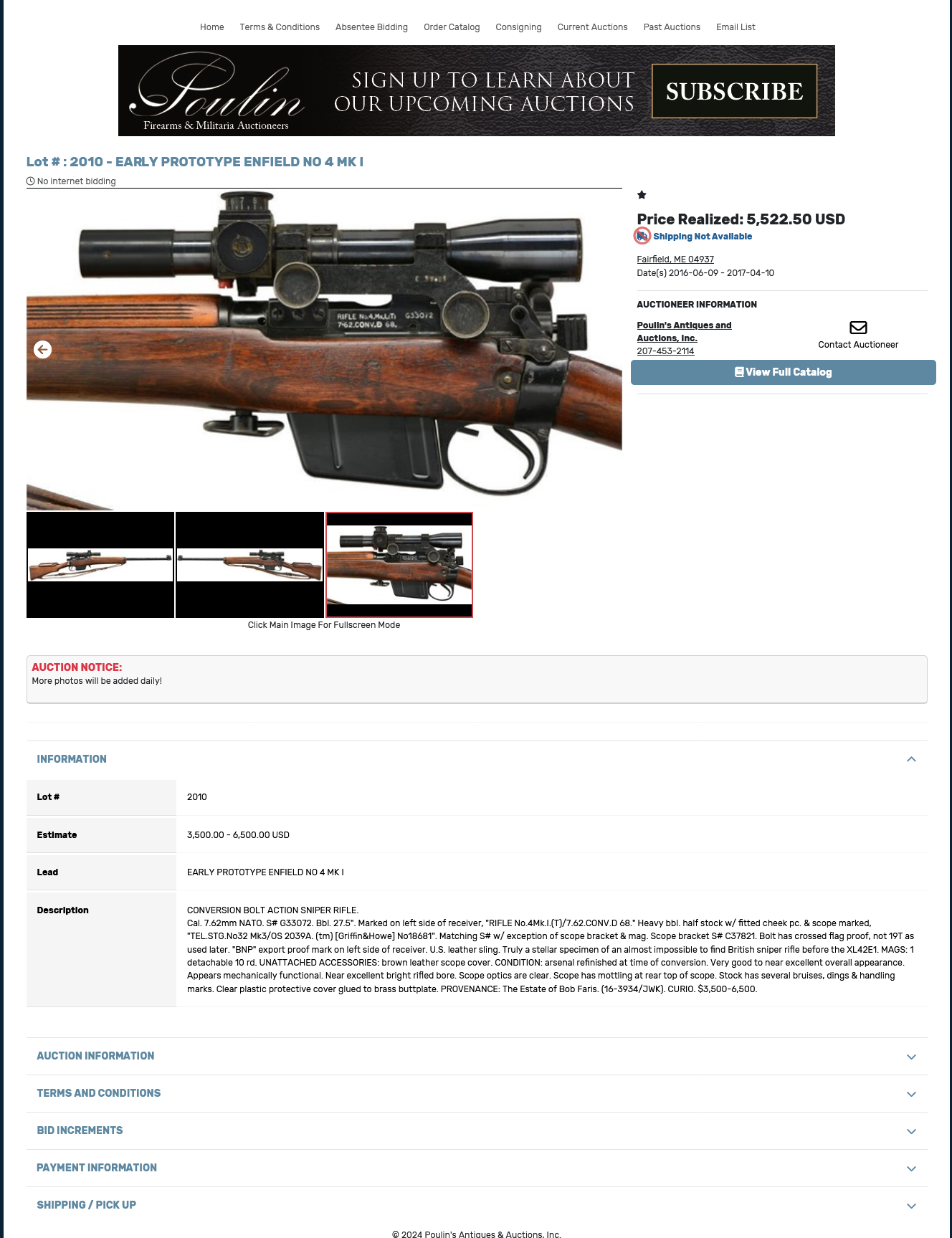

    Sniper rifle "33072" that Peter Laidler asked about in 2011 has surfaced.
    In 2011 Peter Laidlericon asked if either 33072 or 35389, sniper rifles, had surfaced as he had documentation on their use in some trials in 1969. G33072 turned up. No. 4 Mk. I (T) "7.62.CONV.D.68" (the "D" presumably being the Enfield monogram). This message is just a follow-up for those with interest in experimental No. 4 rifles.
    G33072 BONHAMS AUCTION The Charnwood Ordnance Collection of Lee-Enfield Rifles and Accessories 23 Oct 1997, London, Englandicon Lot 141 "A Rare BSA Enfield Converted No. 4 Mk. 1 (T) / 7.62 Trials Rifle, serial no. G33072, converted at Enfield in 1968, pre-L42 hammered barrel, smaller diameter than the norm, standard sights and mounts and Mk. III scope fitted, (scope covers.) Skennertonicon page 217. Sold for GBP 700 in 1997. (Catalogue in Colin M. Stevens' Collection).
    G33072 POULIN'S AUCTION Extract from catalogue - LOT 2010 - "CONVERSION BOLT ACTION SNIPER RIFLE. Cal. 7.62mm NATO. S# G33072. Bbl. 27.5". Marked on left side of receiver, "RIFLE No.4Mk.I.(T)/7.62.CONV.D 68." Heavy bbl. Half stock w/ fitted cheek pc. & scope marked, "TEL.STG.No32 Mk3/OS 2039A. ™ [Griffin&Howe] {Poulin's error in listing } No18681". Matching S# w/ exception of scope bracket & mag. Scope bracket S# C37821. Bolt has crossed flag proof, not 19T as used later. "BNP" export proof mark on left side of receiver. U.S. Leather sling. Truly a stellar specimen of an almost impossible to find British sniper rifle before the XL42E1. UNATTACHED ACCESSORIES: brown leather scope cover. CONDITION: arsenal refinished at time of conversion. Very good to near excellent overall appearance. Appears mechanically functional. Near excellent bright rifled bore. Scope optics are clear. Scope has mottling at rear top of scope. Stock has several bruises, dings & handling marks. Clear plastic protective cover glued to brass buttplate. PROVENANCE: The Estate of Bob Faris. (16-3934/JWK). CURIO. $3,500-6,500. Price realized was USD $5,522.50 The listing is still visible at the time of this posting. Hibid

    Screenshot
Name:	Screenshot 2024-05-26 at 06-37-06 EARLY PROTOTYPE ENFIELD NO 4 MK I Poulin's Antiques & Auctions.png‎
