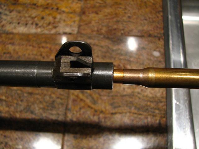

    On our way down to New Orleans (post Katrina) we looped by my good friends in Bhama. He brought out a counter bored carbine that shot (rested) groups as tight as 4"- 5" at 100yrds.
    Can't recall the maker, but do recall it was the first counter bored carbine I had seen shot.
    I couldn't see where you could ask for more out of the carbine.
    I sold a late WRA barrel some years back that was slick clean inside. Though it had a pretty large divet between the lands (Ridges) down about 3" from the muzzle. Using my Poor Mans Muzzle Gauge, it still showed 1/4"+ exposed.
    Only thing I could figure that could have damaged it was a jointed cleaning rod. Don't have it anymore, but at the time was even able to get a picture of that Divet. That divet was deep and elongated. Friend thought a possible drill gun and stainless cleaning brush went crazy. But as stated bore was super clean, unless if they had tried a brush/drill gun, maybe a brush could have broke off causing the damage.
    But then..... Could've been a little of both, Damaged by the jointed rod, then a attempt to lighten it up with a spinning brush...........

    There you go Dave,
    Now that looks real nice.
