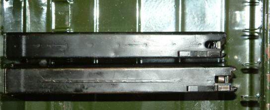

    Oh,I thought you ment that another material was used instead of timber rather than nothing at all.
    With no front rubbing strip on the front of the box the magazines can end up in a heap when the box is lifted by the handle as they are too short to positivly locate in the dividers.
    The problem is even worse on the shorter X3E1/L3 mag's with the FAL locking lug for the
    L4A1 LMG (top in pic).

    Quote Originally Posted by tankhunter View Post
    The LMG mags were placed inside their respective boxes 180 Degrees the opposite way from from a .303" Bren Mag.
    Just a small point Tankie but they are placed in the box in the same orientation.
    303 and 7.62 LMG mags can only be placed located in the brackets inside the boxes the same way, with the mouth of the magazine facing the hinge of the box.The exception being the early X3E1 magazines with inward bottom plate retaining lips which allows it to be placed either way round.
    The inside lid top rubbing strip as you say does prevent some movement but will not stop them becoming dislodged.
    The necessity for a front rubbing strip to the early converted 7.62 boxes by whatever material means to keep them in check must have been taken into account as there were 2 different types of early boxes.One for the shorter FAL locking lug X3E1/L3 mags and another for the later commonwealth locking lug L4A1 mags.I would assume the differences in the boxes was the depth of the front rubbing strip to take into account the difference in the length of the magazines.
