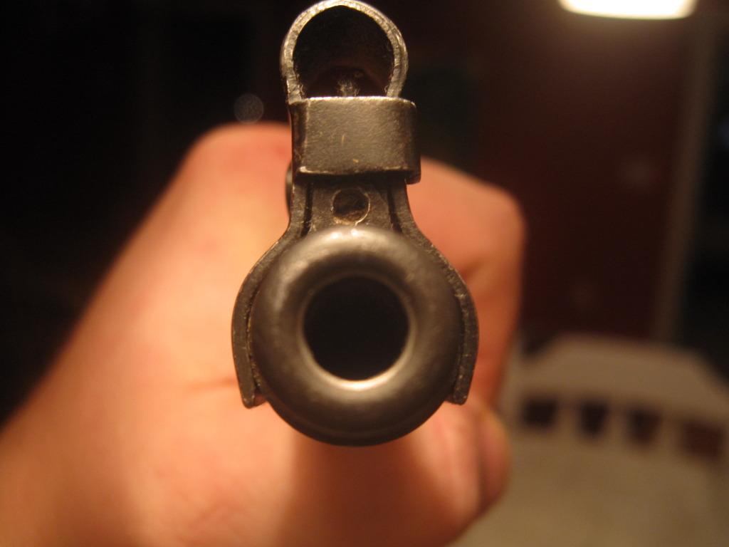

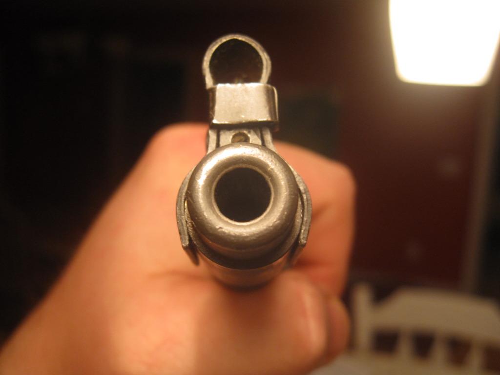

    I would not be too quick on letting that rifle go. How about a photo of the muzzle? If you really want to know more on the rifle and its value, this is the place, period. I don't think you answered the question on the raceways being polished or not. Is there a Star gauge number under the handguard? Usually a letter and two or three numbers. Lots of folks here that are knowledgeable on NM rifles (not me!). Be patient.
    If you want more of a issue type '03, there are plenty out there. The rifle you have could be worth $2000-3000.

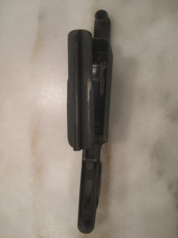

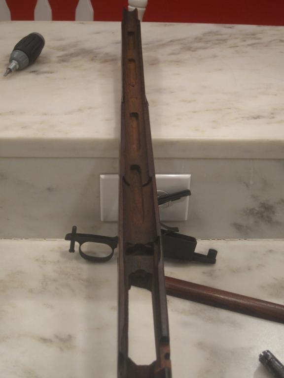

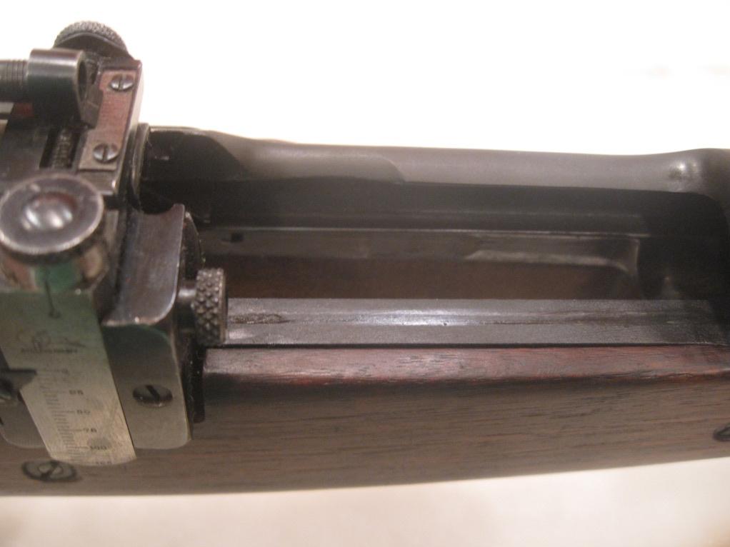

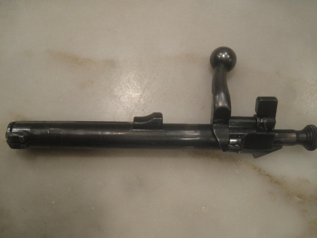

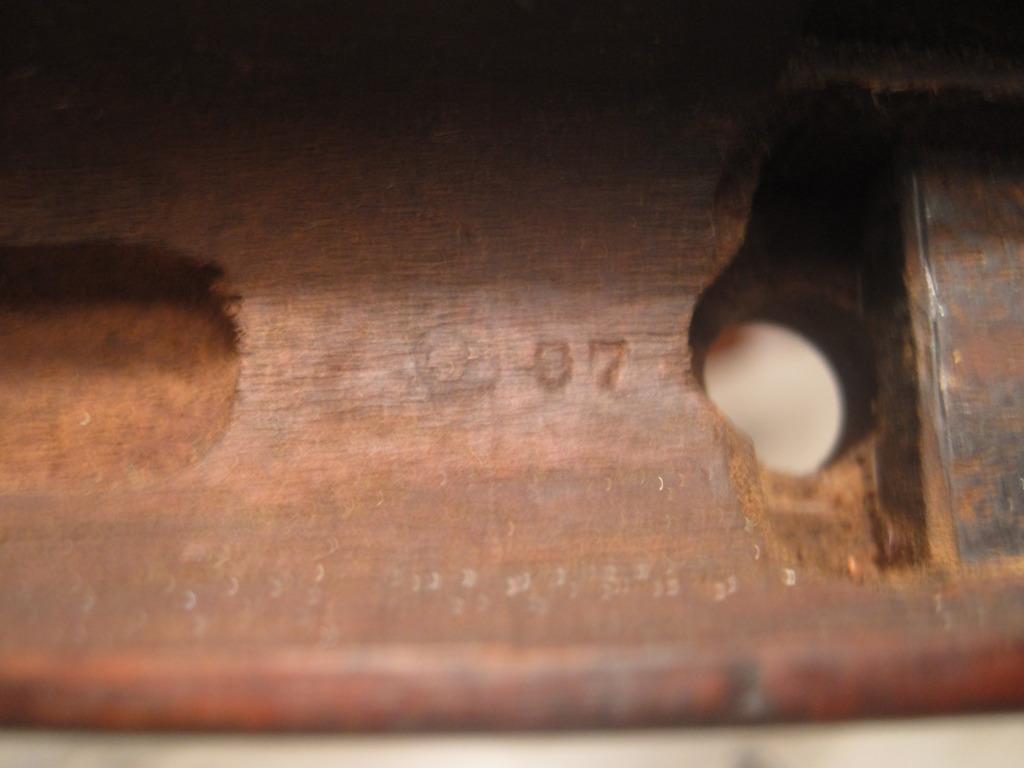

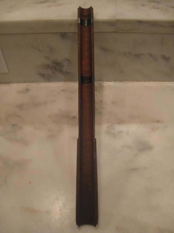

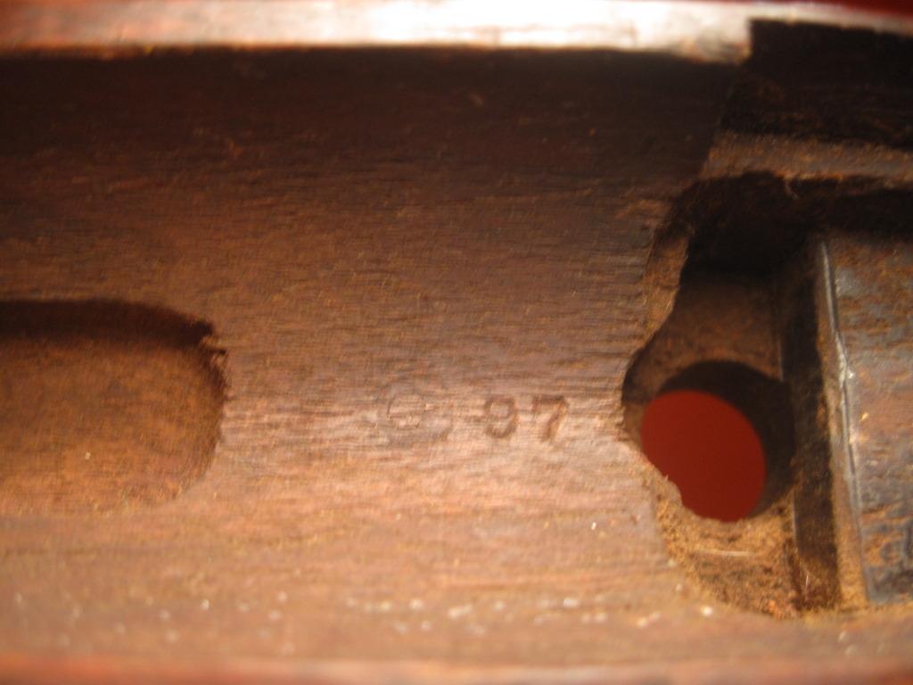

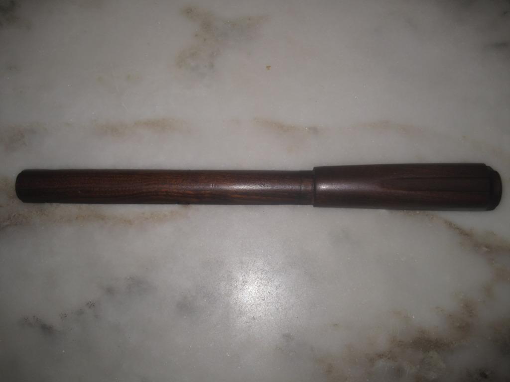

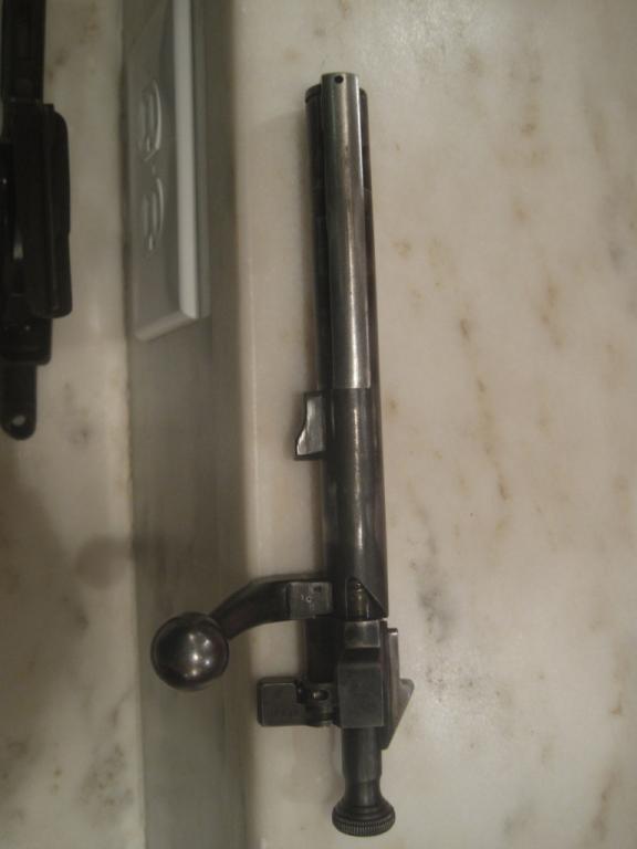

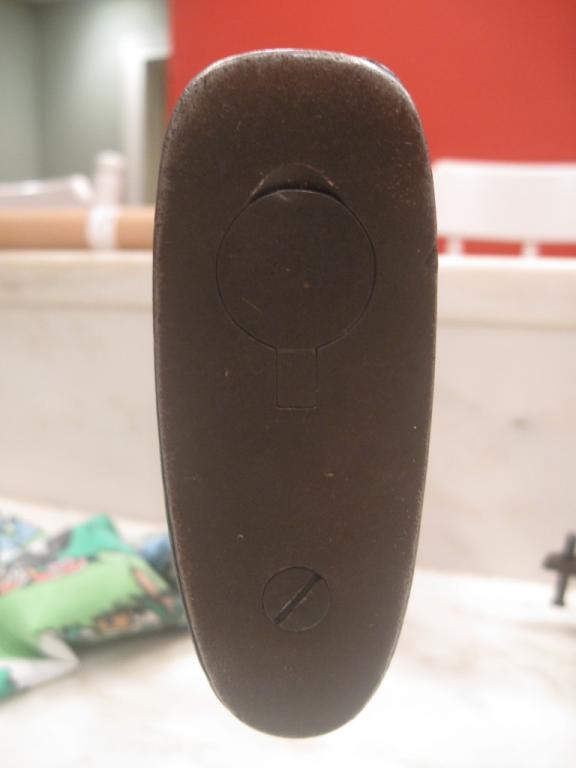

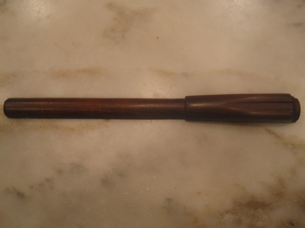

    More pics

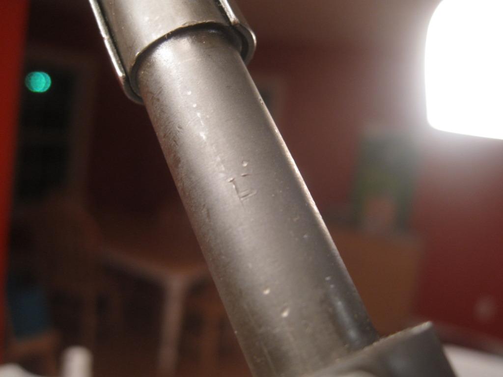

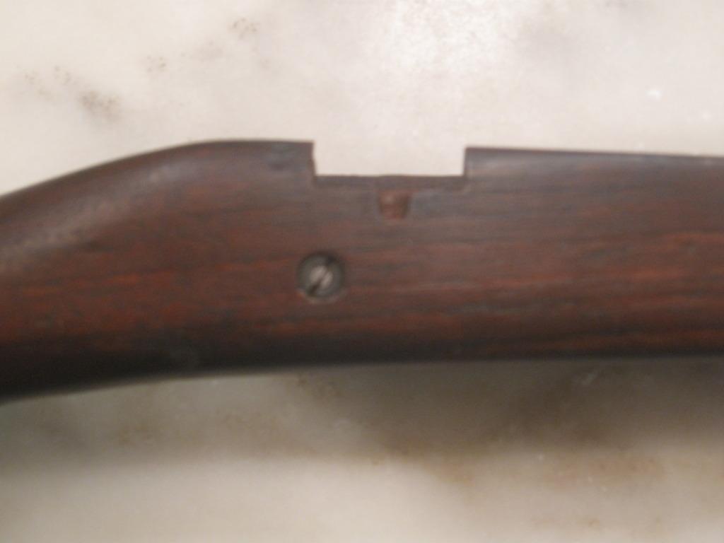

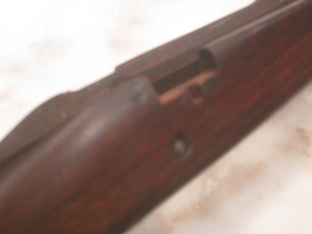

    I finally took in apart. I found no serial number on the bolt or under the hand guard. Under the handguard on the barrel I did find what looked like "R 1 0" or maybe the "0" is a 2? On the flat part of the underside of the receiver it's stamped N S, with J J 100 underneath it. The first "J" looks almost like a mis-stamp/double stamp because it's alot lighter than the "J" closer to the 100. I also found what looks like a "98" stamped in the stock.
    Here's some pics, what do you think?

    This appears to be a very nice issue rifle that has been set up for match use. Nice rifle, not a National Match, that I can tell.

    Looks like the Greek stamp under the barrel ?

    I thought the Greeks usually had stamped numbers on the stock, pinned the floorplate and marked it-"B". I haven't read/found anything about marking under the barrel.
    Calif-Steve- yeah that's what I figured after reading stuff here, it was missing all the key parts- star barrel, numbered stock/bolt, checkered buttplate. I showed it to a guy this weekend and he said what you did- a nice match rifle but not a national match rifle. He also said it was a military match modified rifle, which I guess means it okay to use in military matches??

    It was posted on this forum - about that U type of stamp under the barrel only found on the 1903's returned from Greece
